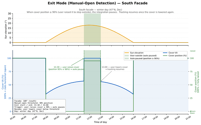

Exit mode (manual-open detection) If you raise a blind above a configurable position threshold — for example, to step out onto a terrace — the
integration detects this and pauses auto-control for that cover until you lower it again. It complements the existing sleep mode (manual-close
detection) to give you full bidirectional manual override protection.

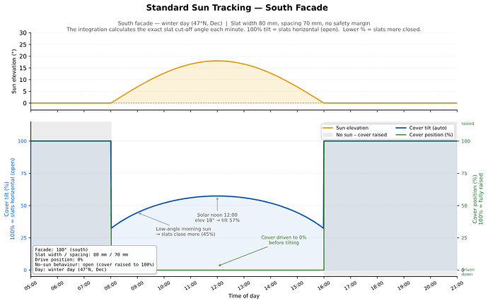

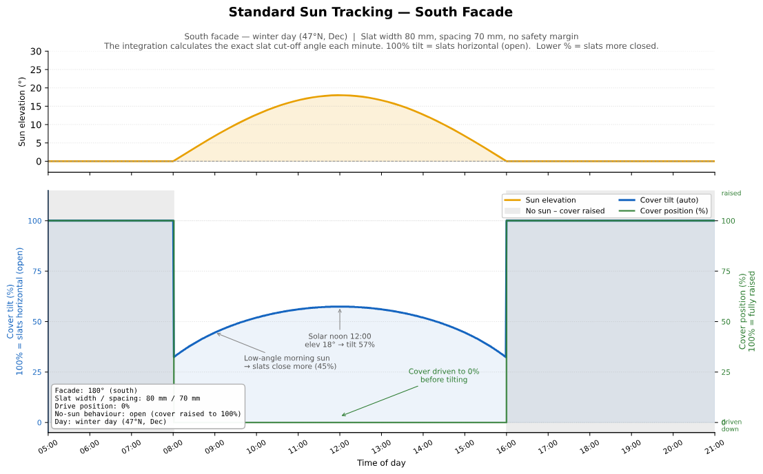

South-facing facade (winter day) — baseline sun-tracking: Image: Vanilla behaviour

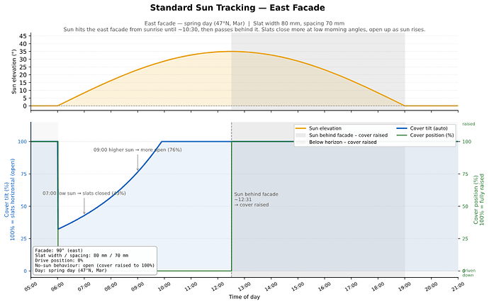

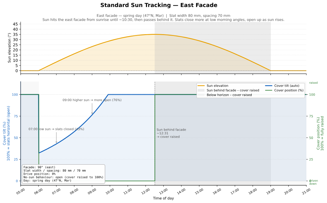

East-facing facade — morning tracking, raises when sun moves behind facade: Image: East facade

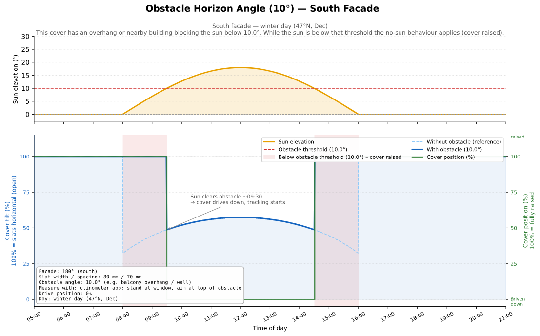

Obstacle elevation — neighboring building blocks sun below 10°, cover raises: Image: Obstacle elevation

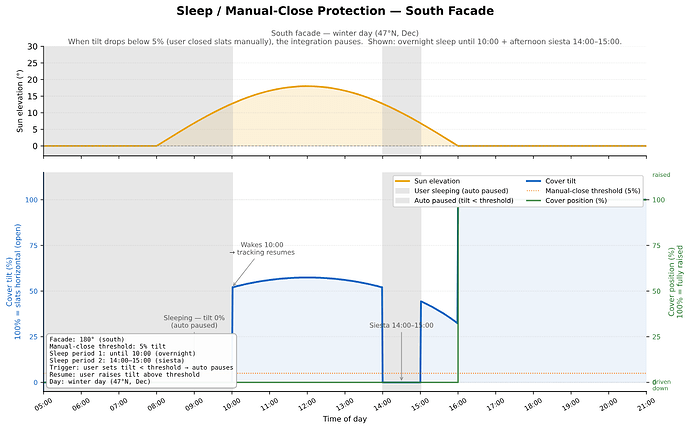

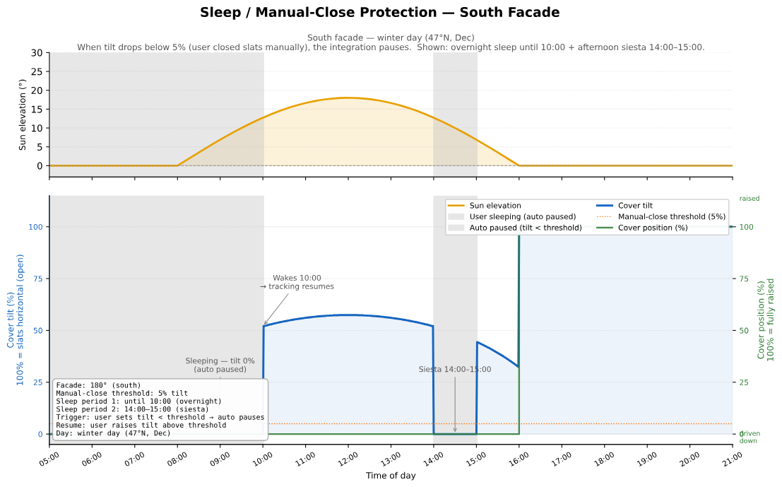

Sleep / manual-close protection — user closes slats, integration pauses: Image: Sleep protection
Exit mode — user raises cover to step outside, integration pauses: Image: Exit mode

  • Sleep mode — pauses when user closes slats manually
