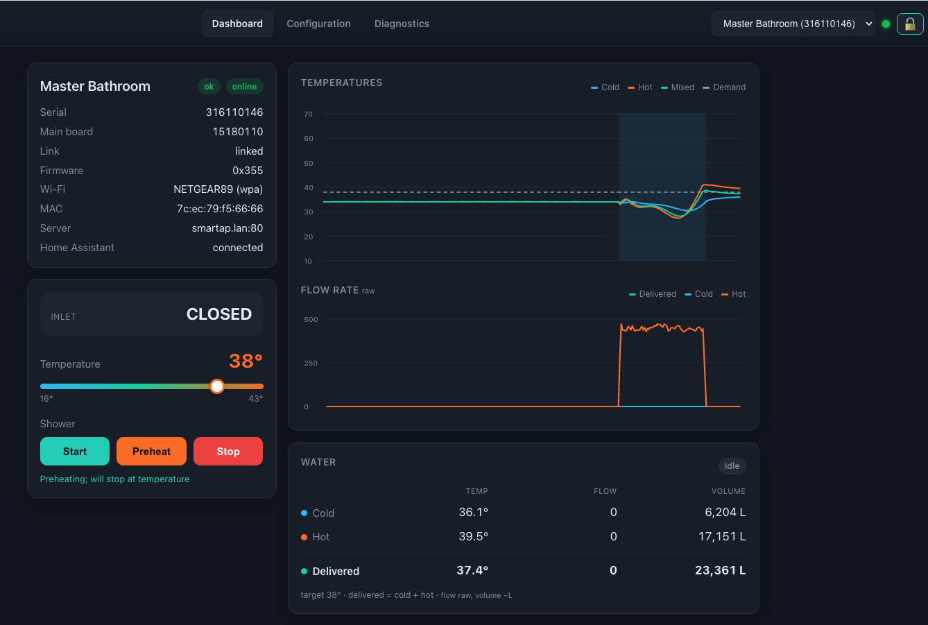

Here’s a quick preview of the dashboard that runs on the pico pi
@vanderag has put together a HomeAssistant Add-On which bundles this.
At release time, we’re fairly confident this should be a matter of plug in, some light config (wifi), and HomeAssistant integration comes as standard.
