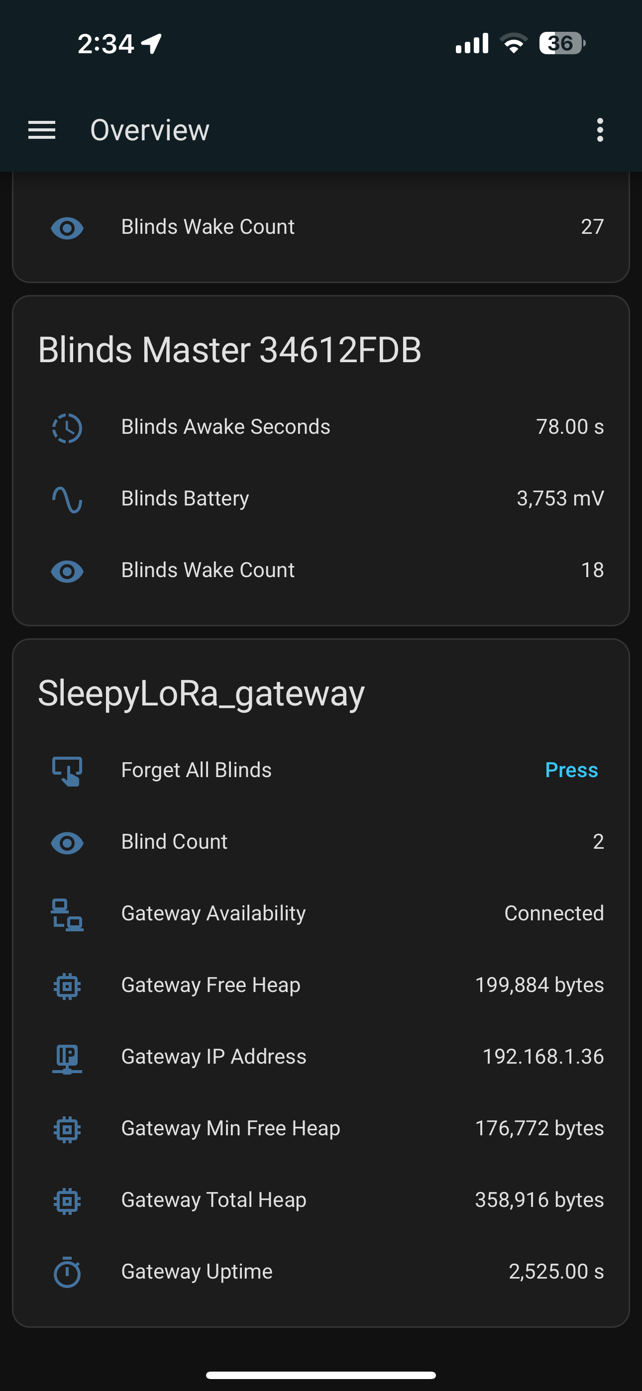

Edit: Connected 2/2 without issue!

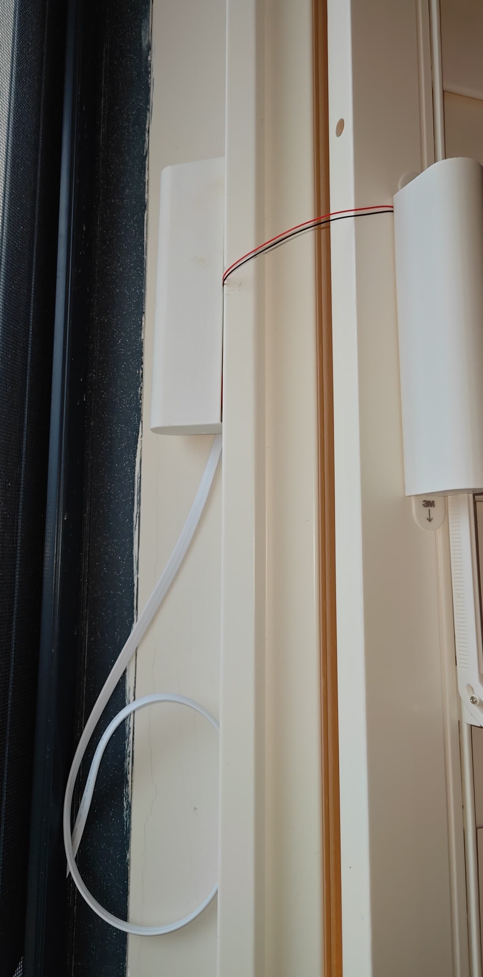

I haven’t yet designed a case for it… I actually just used double sided tape to stick it all to the wall, then put a spare actuator cover over it for now… and it’s out of sight out of mind at the moment
One thing with solar panels is if there is the slightest shading on one part it massively effects power output, so make sure it gets full sun… I found the bottom of my windows get more light than the top. for west and east windows I mount it outside in the window recess in a vertical orientation so it gets north facing light (in Southern hemisphere). I’ll add a picture when I get home

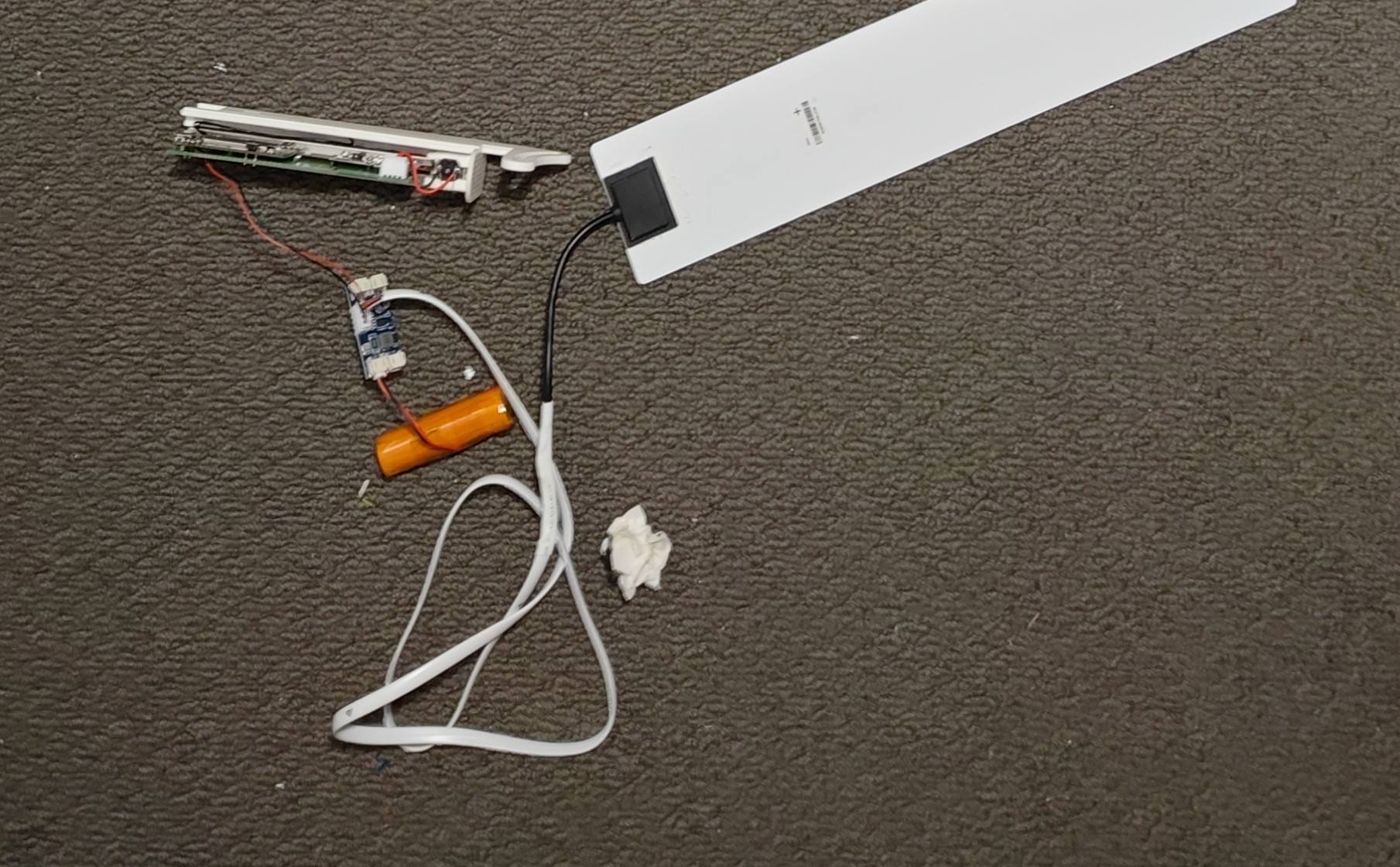

I have tried a few different solar controllers but found the one in the BOM to be best value for money. Below is a photo of my old setup, but the wiring is more complex because I crimped my own jst connector on for a different controller board… then migrated to the new board. The new setup as described above using the 2pin plugs that come with the solar charger boards makes it so much easier

Thank you, the seems to have resolved the frequency issue, and the blind has re registered into MQTT,
still playing around but still having trouble getting it to communicate commands.

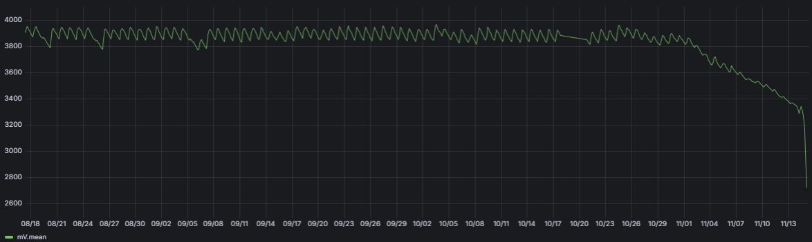

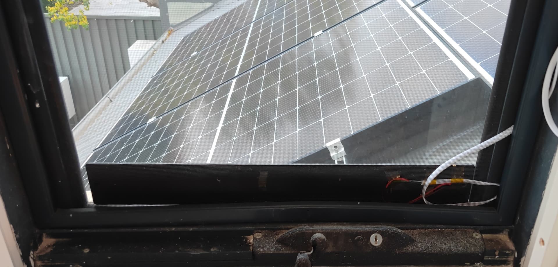

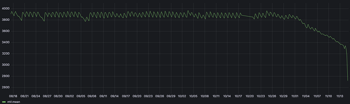

Who would have thought that solar charging in summer would be more difficult in summer than in winter? the issue seems to be that the solar panels in the windows are no longer getting direct sunlight, with the winter sun low in the sky they recharged most days and only during full cloud cover days would they not charge… but with the reasonable battery life it wasn’t an issue.
No as we come into summer the sun high in the sky there just isn’t enough direct sun on the panels… the shadow cast by the eve’s blocking the sun just enough to make no power.
unfortunately now i have 8 devices offline for this reason… and need to find another way.

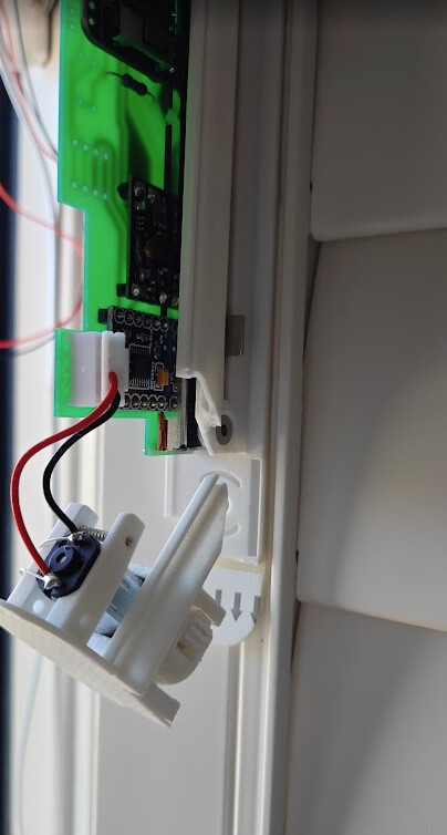

The other issue i have is the resin snapping… I need to beef up the design around the drive mechanism as I’ve had 2 devices fail in the exact same place now on the exact same shutter! i think its a bit tighter than the other blinds and often doesn’t disengage properly, then when my wife wants to go to sleep its slammed closed! it should be a reasonably easy fix when i get the time.
What kind of battery life do you get without solar? Presumably these don’t use a lot of power so if you can minimise idle current that 1850 must last a couple of months?
Must have been super annoying to have the part fail like that, but I’m wondering what kind of torque you must be having to actually snap the plastic? With my blinds I can loosen them all the way so the amount of force required to move them is quite low. Im wondering if you might have the same ability to adjust them?

they get about 10days without charging. they should be able to get 1000x longer but i just cant get the things to wake and respond to commands… so basically they are always in active listening mode with the esp32 sleeping
the plastic breaking is no so much from the torque rotating its the pressure applied on the gears pushing the rack outwards… and resin printed stuff is just brittle… and its just too thin
my blinds are the cheapest oldest blinds around… there is no adjustment at all… just how much lube i spray on the pins! but i have lubed them well so they dont take much to move.
