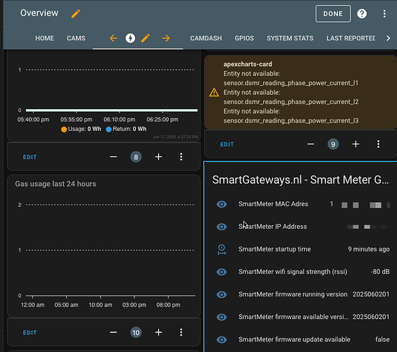

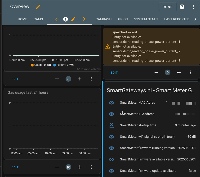

- Entities are not available.
- Developer Tools → States → Entities: the entities are indeed not there, BUT…
- Settings → Devices & Services → Entities: the entities ARE there but they are set to
disabled
- Now entities show up but all values are 0

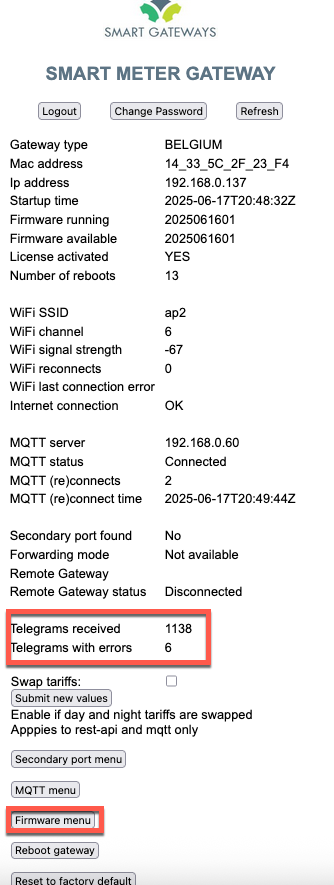

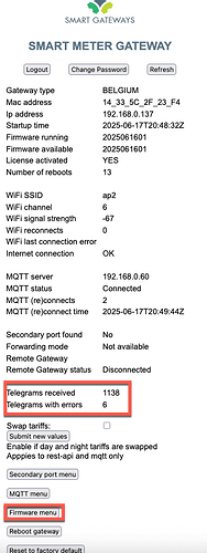

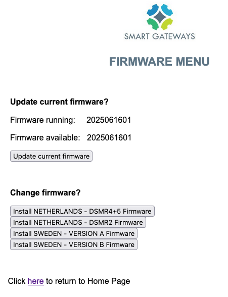

On the smartMeterGateway’s internal web page, I see:
|Telegrams received |84|
|Telegrams with errors |84|

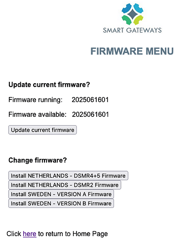

Reason: wrong firmware
Solution: → Firmware menu → I had to chose Belgian Firmware (now it is no longer in the screenshot because it is installed)

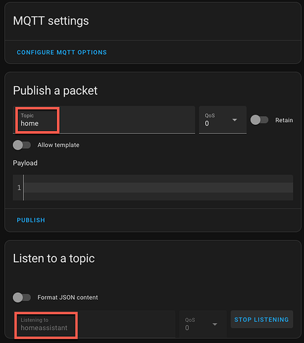

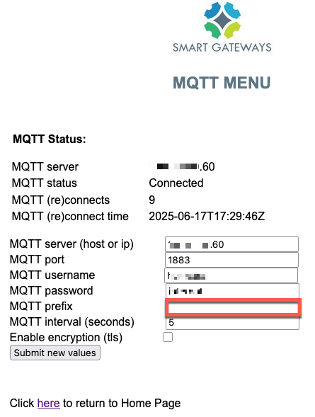

- In the SmartGateway’s web page, leave the MQTTP prefix blank (that is: if you don’t know know what you are doing, like me)
The documentation says to leave the prefix
field in the smartGateway config empty; which I did

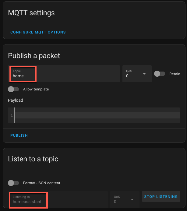

I HA → MQTT settings → Listen to a toppic: I see
homeassistant
I’m not sure if that is correct and/or how that relates to the MQTT prefix in the SmartGateway’s configuration (where it is set to blank)Hopefully this helps somebody
