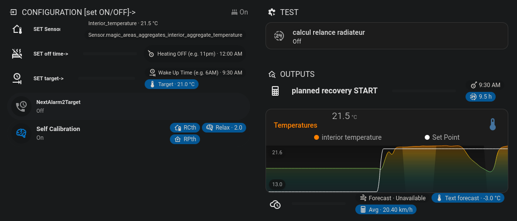

Another question, is SmartHRT only for people with radiators?
I have electric heating and I tried for 2 nights. The first night, the heat started back many hours too early (maybe like 4 h).
The second night, the heat started exactly at the target time.
I do reboot my home-assistant often. I did yesterday.
maybe try 3 or 4 nights without restarting HA, the issue is the first learning process of your dwelling constants.
Yep, I can see from your curves that your heating curve is steep, so maybe you can first set the values a bit differenttly from the default values (50):
  • clic on Self Calibration to set it OFF
  • set RC_lowWind and RC_highWind to 50
  • set RP_lowWind and RP_highWind to a higher value, let’s try with 300 or 500
  • clic again on Self Calibration to set it back to ON
  • see after 3 or 4 nights if it’s getting better without restarting HA
