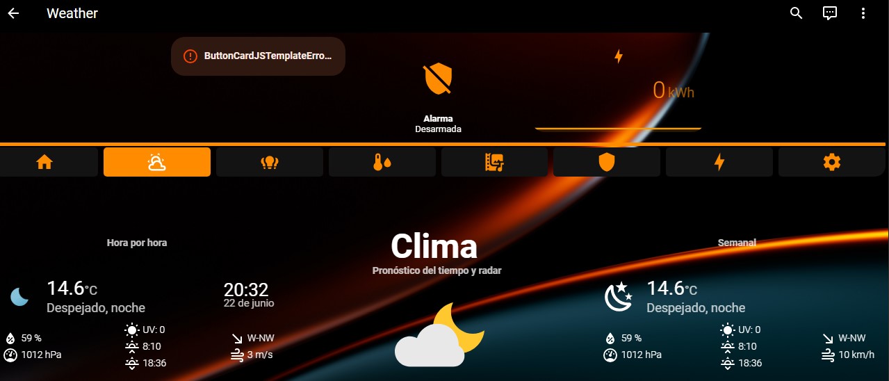

Excellent panel, thanks. I’m testing it. Great job. On the climate card, it says the button card isn’t configured. Could you tell me what the error is? I’ll send you an image. Thanks.
Hi and thank you!
Yes, you need to configure a ping sensor called «smarti.internet»(pingibg the address «8.8.8.8» - googles dns server) as per the documentation in the repo. When configured, the sensor will give you both history and status of your HA installation internet connection.

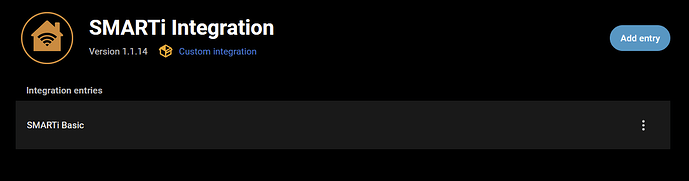

Installed it “automatic” mode, entered token, etc… Restarted HA twice, cleared cache - the dashboard does not appear anywhere, I can only see the integration in Devices and Services:
But… not a single way to access the dashboard itself !!! And he asking ~3$ / month for the “pro” version…? At least when you install Dwain’s - it works.
