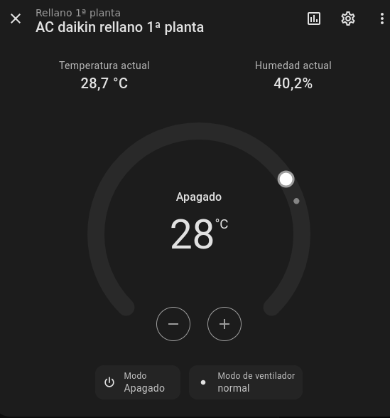

After update HomeAssistant, I must migrate the new template entities in 2025.12 because will be deprecated in 2026.6.
I updated too the sensor used for power_sensor, from sensor to binary_sensor, and it works, but now the card in the dashboard don’t update his value as “power on”.
In development tools can see that the binary sensor works:
But in the dashboard it appears as poweroff:
imagen
This is my climate code in the configuration.yaml (works before with sensor instead of binary_sensor):
smartir:
    check_updates: false
climate:
  - platform: smartir
    name: AC daikin rellano 1ª planta
    unique_id: daikin_AC_rellano_planta_1
    device_code: 99999
    controller_data: "zigbee2mqtt/IR rellano 1ª planta/set"
    temperature_sensor: sensor.termohigrometro_rellano_1a_planta_temperature
    humidity_sensor: sensor.termohigrometro_rellano_1a_planta_humidity
    power_sensor: binary_sensor.a_a_rellano_1a_planta_estado
    power_sensor_restore_state: true
And my templates.yaml:
- binary_sensor:
  - default_entity_id: binary_sensor.a_a_rellano_1a_planta_estado
    name: "Estado del A/A del rellano de la 1ª planta"
    state: >
        {% if ( states('sensor.medidor_corriente_a_a_1a_planta_power_a') | float > 0 ) %}
            on
        {% else %}
            off
        {% endif %}
Someone with the same problem?

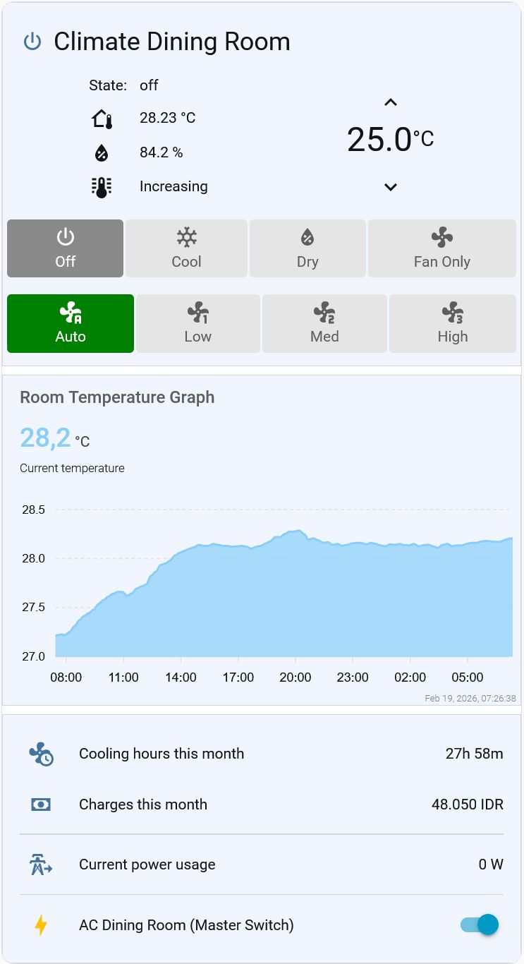

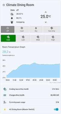

I used THESE “ZigBee Socket Switch Module KWh Meter Energy Monitor devices” installed between the electricity line and the AC units. They are small enough to be hidden behind the cover of the indoor units.
Then I closely monitored electricity usage for different HVAC modes like cooling, heating, fan only etc. to draw conclusions in which mode an AC unit is actually running at.
With all the data collected it is easy to build automations to reflect the mode an AC unit is actually running at to use with one of the many theromstat cards available for Lovelace.
The outcome within HA looks like this:
All this works surprisingly well and very reliable with the IR blasters used since many years now.
