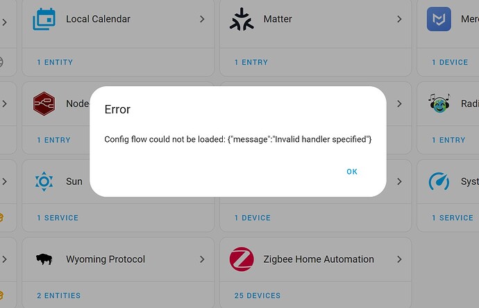

It seems the latest update for HA Core 25.7.1 has broken the smartlife intergration, getting the following message when attempting to add hub “Config flow could not be loaded: {“message”:“Invalid handler specified”}” unable to do anything with the intergration, has anyone else suffered the same issue? all devices within smartlife are now unavailable.

For me it’s the core integration, from Settings, Add Integration.
I get the same error.
Just loaded HA Operating System v16.0 and get the same error.
Log file: Log details (ERROR)
Logger: homeassistant.config_entries
Source: config_entries.py:3733
First occurred: 2:56:10 PM (1 occurrence)
Last logged: 2:56:10 PM
Error occurred loading flow for integration smartlife: No module named ‘homeassistant.backports.enum’
smartlife is deprecated. Use the Tuya integration in code instead.
