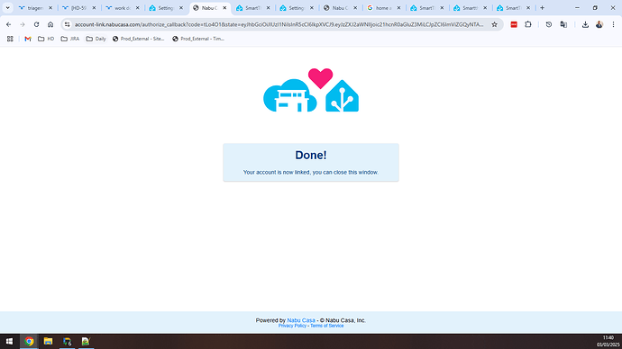

I can’t add smartthings integration to my home assistant.

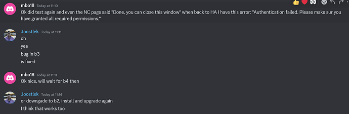

I authorize everything, nabu says everything is OK, but in the end, home assistant gives the error “Authentication failed. Please make sure you have granted all required permissions.”
Looking at Discord, it looks like there is a bug in B3 that has been fixed, you could wait for B4 or downgrade to B2
The latest version (2025.3) seems to have fixed the integration! Hope it works out
