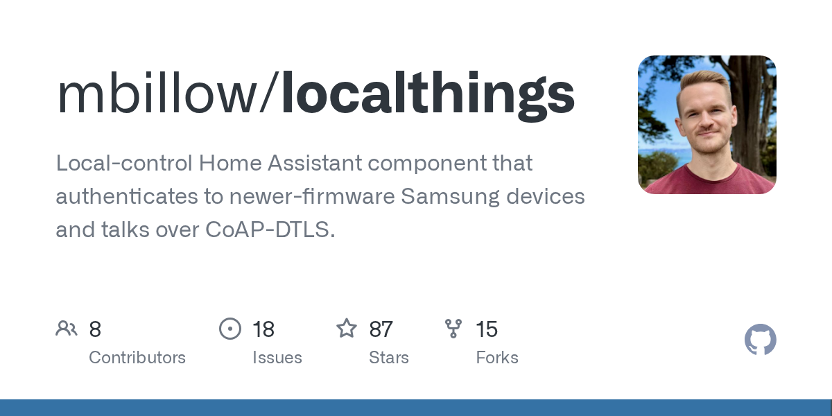

Here is a way to pull at least some Samsung gadgets into HA and run them completely local.
Works very well with my Samsung Foodcenter (Fridge/Freezer) - I get all the sensors I had before with Smarthings.

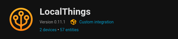

Just wanted to thank you guys for pointing out the LocalThings integration! Definitely worth looking into. I’m finally getting a managed switch for my network tomorrow, so once the dust settles I will definitely be digging in to that to see what I can do with my over-the-range microwave and my washer/dryer combo. Bought them in the last year or so, so probably good candidates.
Thanks a lot for this.
Gathered the certificate and private key through Powershell in Windows and managed to add a Samsung Dryer.
Much-much more sendsors and controls are available vs what I had in the Smartthings integration.
