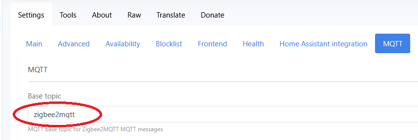

Does the existing Zigbee2mqtt network, and the Smhub Zigbee2mqtt network use different mqtt topics, and different Zigbee channels ? Second is advisable but not really necessary, but the first one definitely is.
or new frontend
Different channels yes, same port but with different IP and same topic
But if I use a different topic in SimHub (for example, Zigbee2MQTT Hub), Home Assistant won’t recognize the devices, will it?
Yes, HA will find them

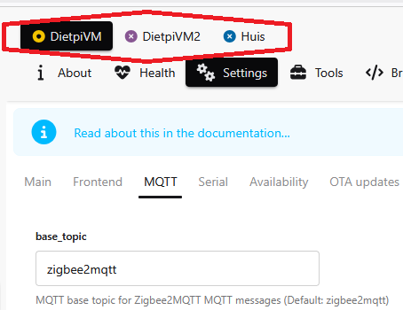

3 Zigbee2MQTT’s each it’s own topic.
