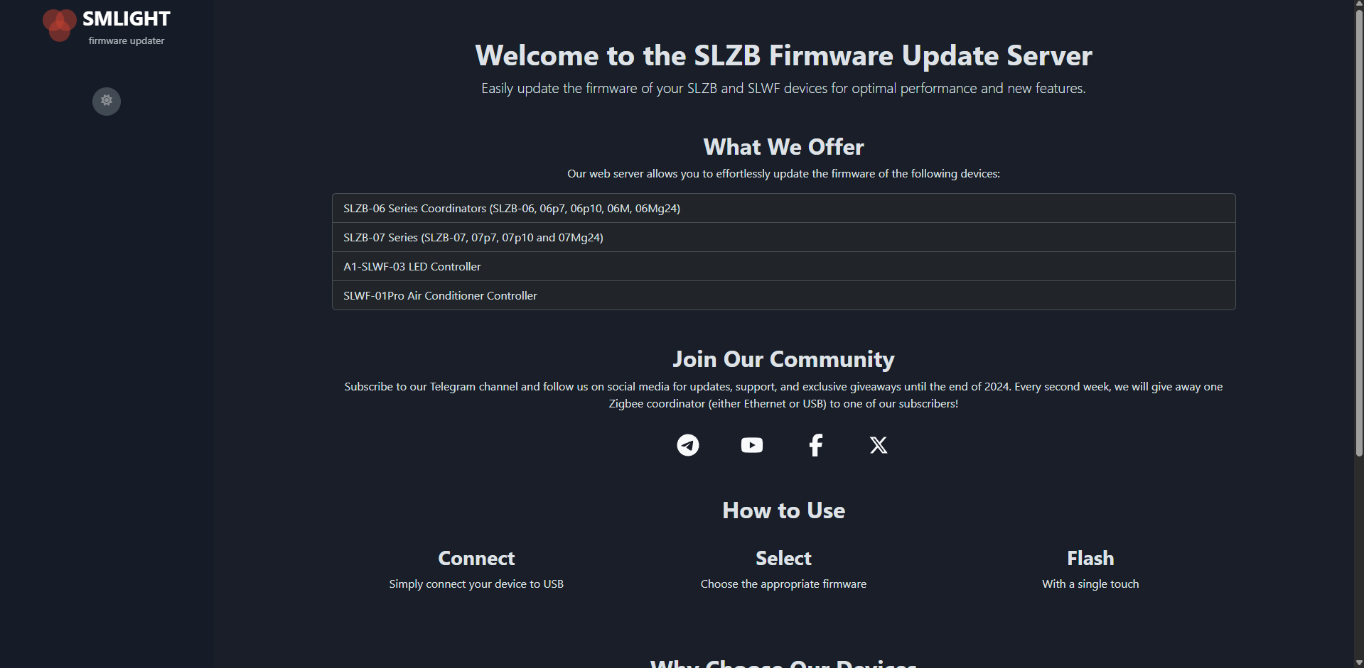

When I manually connect to smlight.tech/flasher, some text initially shows up then immediately shows a 404 page. The firmware doesn’t appear to be downloadable from anywhere on their website.

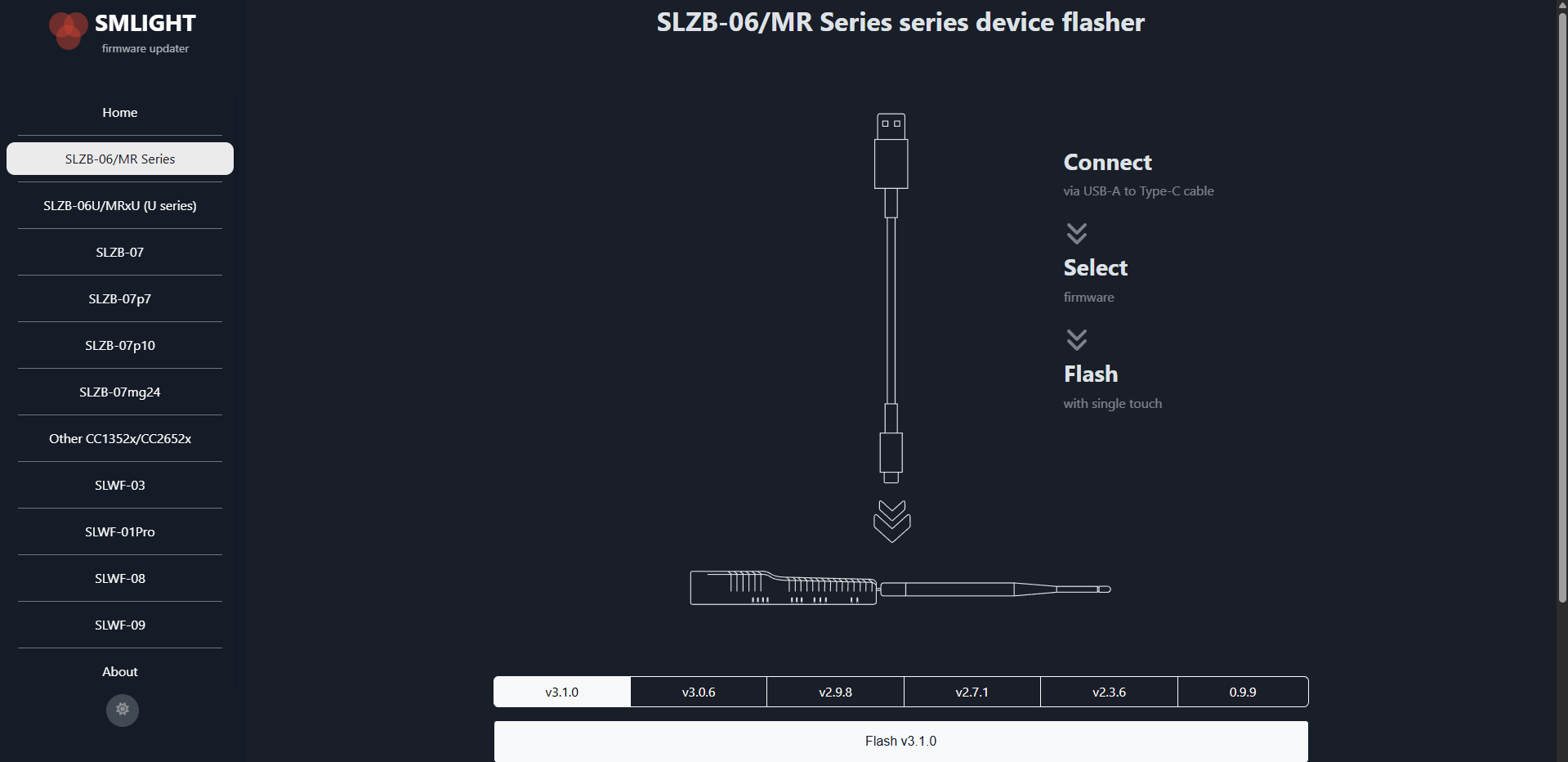

The page renders for me, but there are no options to choose the right stick or firmware. It’s the same whether the device is plugged in or not.

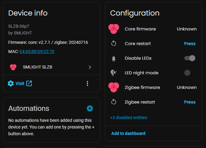

I also tried installing the SLZB integration to possibly update that way, but core firmware and zigbee firmware versions are “unknown” despite being reported in the device info

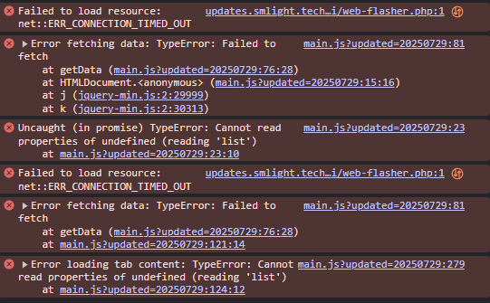

I took a look at the chrome console and realized I had a timeout to updates.smlight.tech
temporarily disabled my geofirewall and was able to view the full page
OTA updates also worked no problem, so looks like I’ll have to whitelist their IP.
That was the issue! I had certain countries blocked. Off that the main smlight site was fine, just the downloads area was hosted on some other infrastructure.
