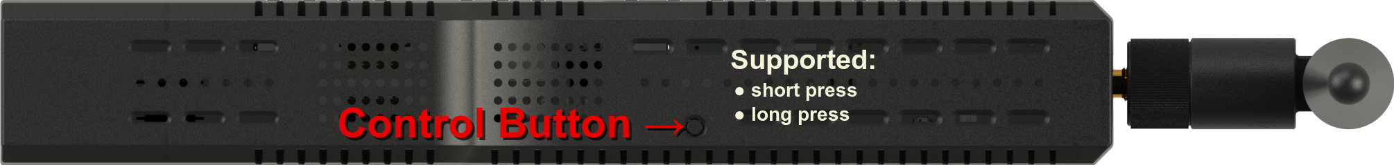

Configuring with Button
Using the physical button, the following settings are possible:
  1. Changing the device operating mode from Zigbee-to-Ethernet to Zigbee-to-USB and vice versa. The operating mode of the device is changed by short pressing the button.
  2. Controlling the behaviour of LEDs. Long press - turns off the LEDs. Another long press - switches the LEDs to the default operating mode.

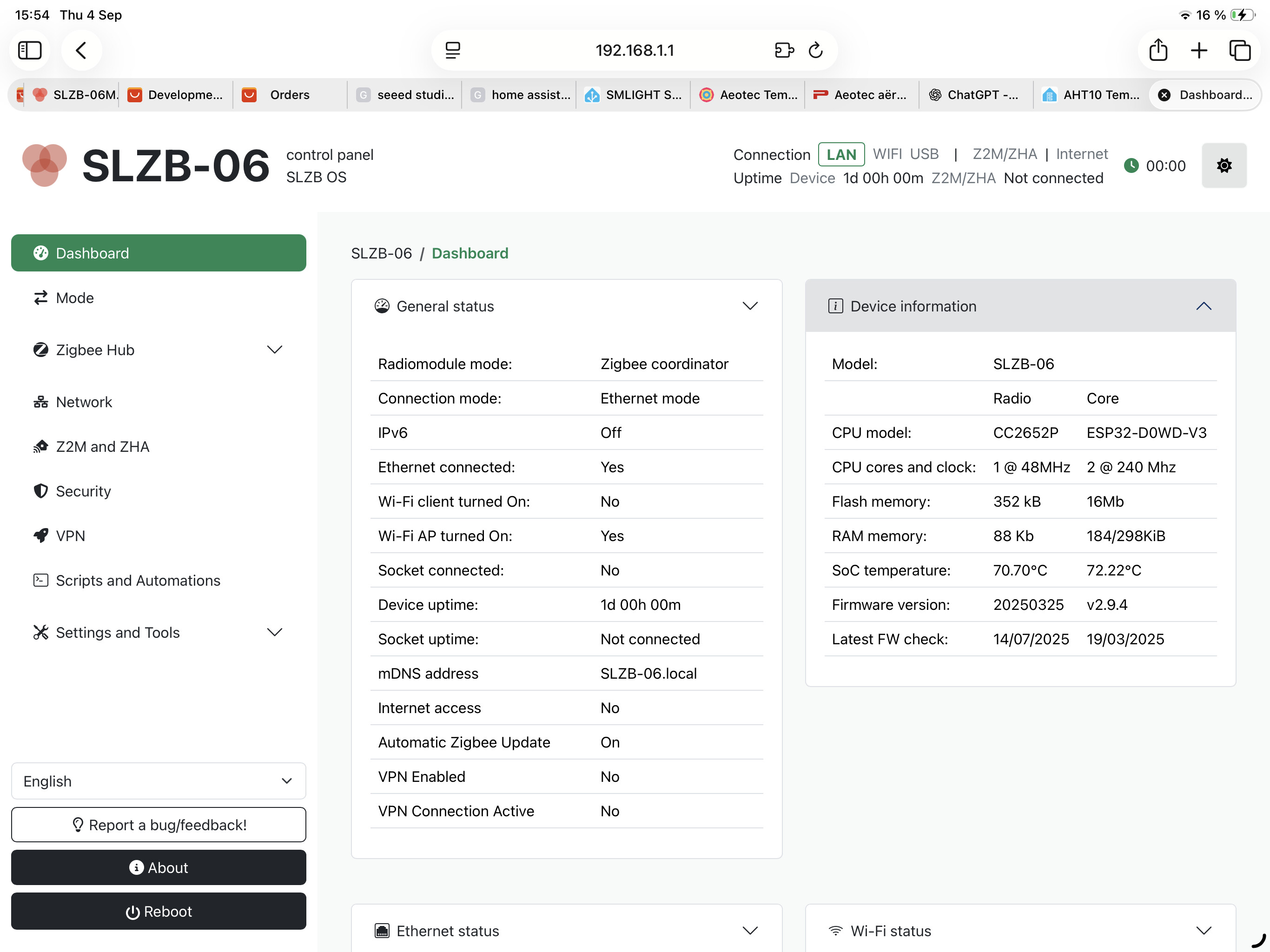

It seems to be a malfunction with the Ethernet port. I unplugged the cable , connected to the Wi-Fi the SLZB created, and used the web interface to set it to WIFI instead of Ethernet, changed the z2m ip address and now everything is working.
When searching it seems like a lot of people have problems with the Ethernet port
Did you do a firmware upgrade via HA vs the SMLIGHT UI?
I haven’t intentionally done an upgrade, so it’s probably done from HA.
The reason I posted here was that I seem to have the same problem when I discovered that it wasn’t working. But it seems like my reason is a dead Ethernet port like so many others have I found out. It works again as normal when it’s set to WiFi.
I also checked the IP address when it was set to Ethernet and it didn’t get one, but showed as connected.

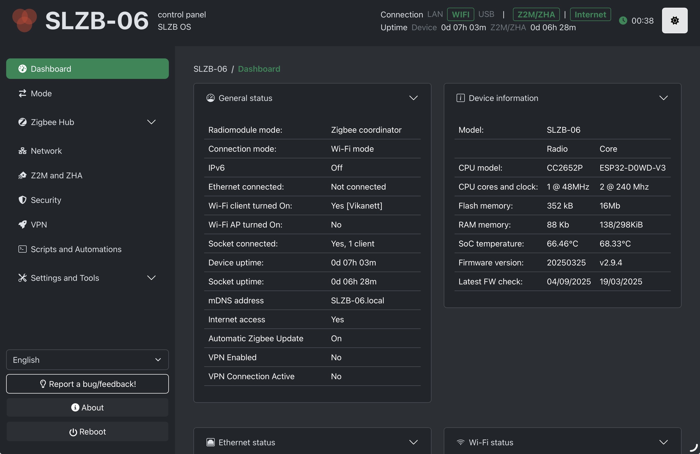

Here is it up and going with WiFi, and you see the FW
