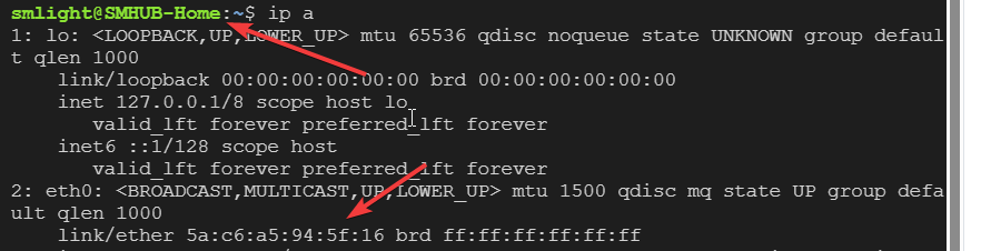

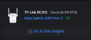

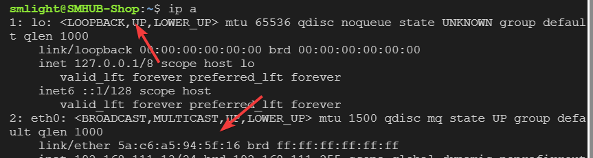

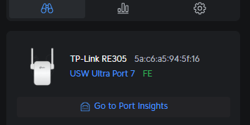

An interesting thing happened today… I have an super edge case but figured I would let you guys know… I ordered 2 SMHUBS, I am running DHCP reservations on my IoT network, which is bridged over a few acres and multiple buildings. Any who when I installed the 2nd SMHUB my Unifi deployment kept trying to give the new hub the same IP and the first one I deployed… unplugged the 1st one and sure enough the new one stole the IP… after investigating they both have the same MAC address which is tied to the DHCP reservation…
two separate devices… plugged into different segments on the same VLAN…
I have yet to find a way in SMHUB-OS to modify the MAC so I can run both of these devices at the same time…
