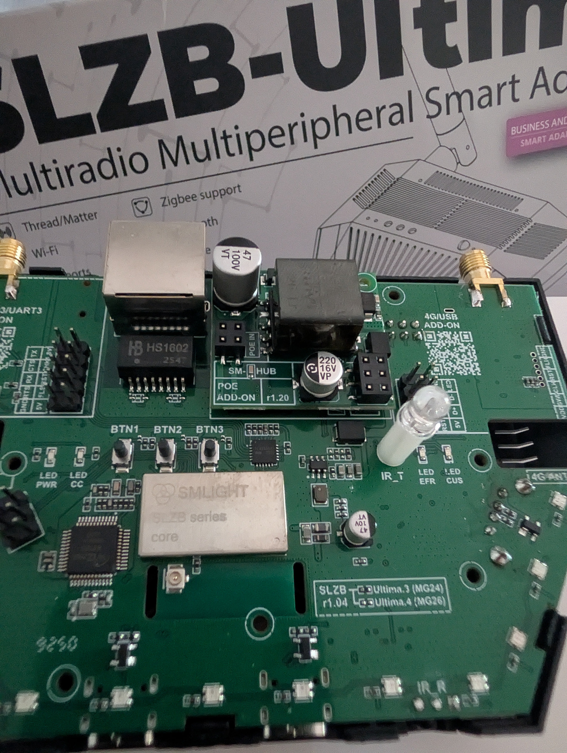

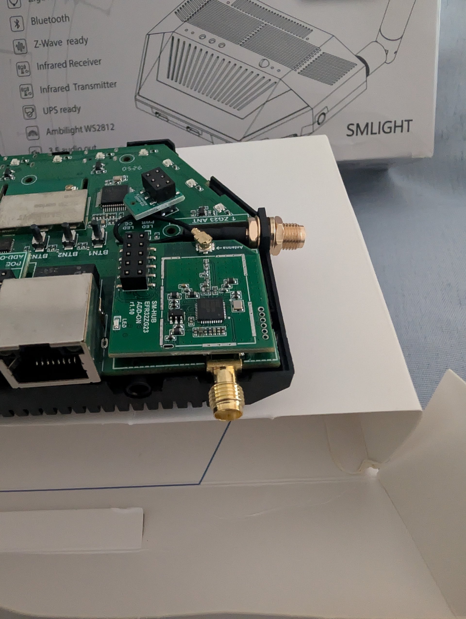

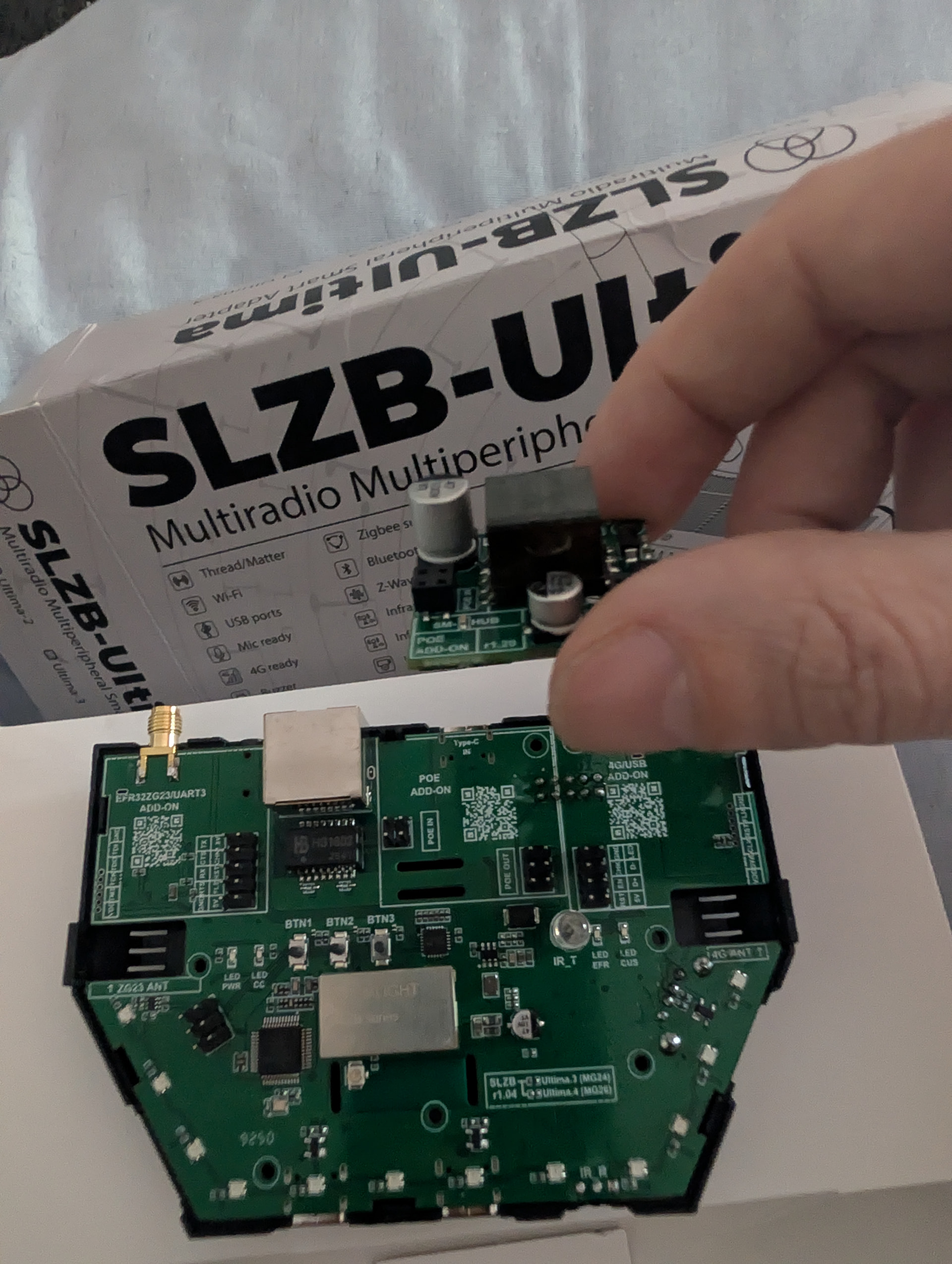

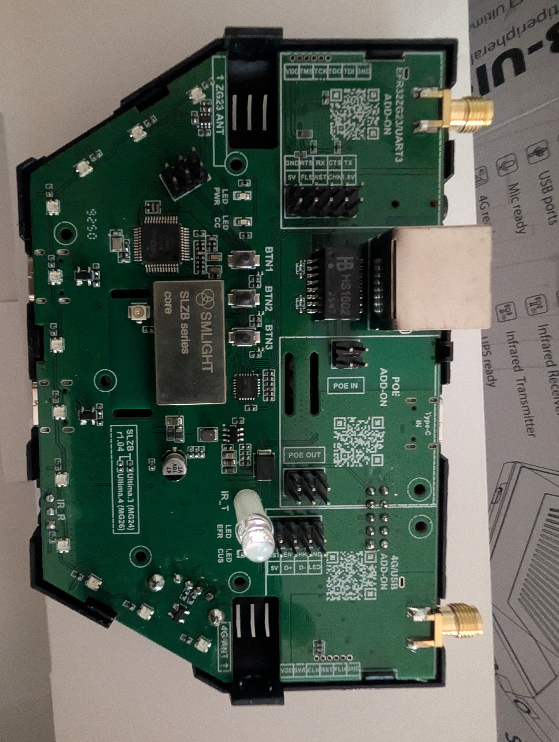

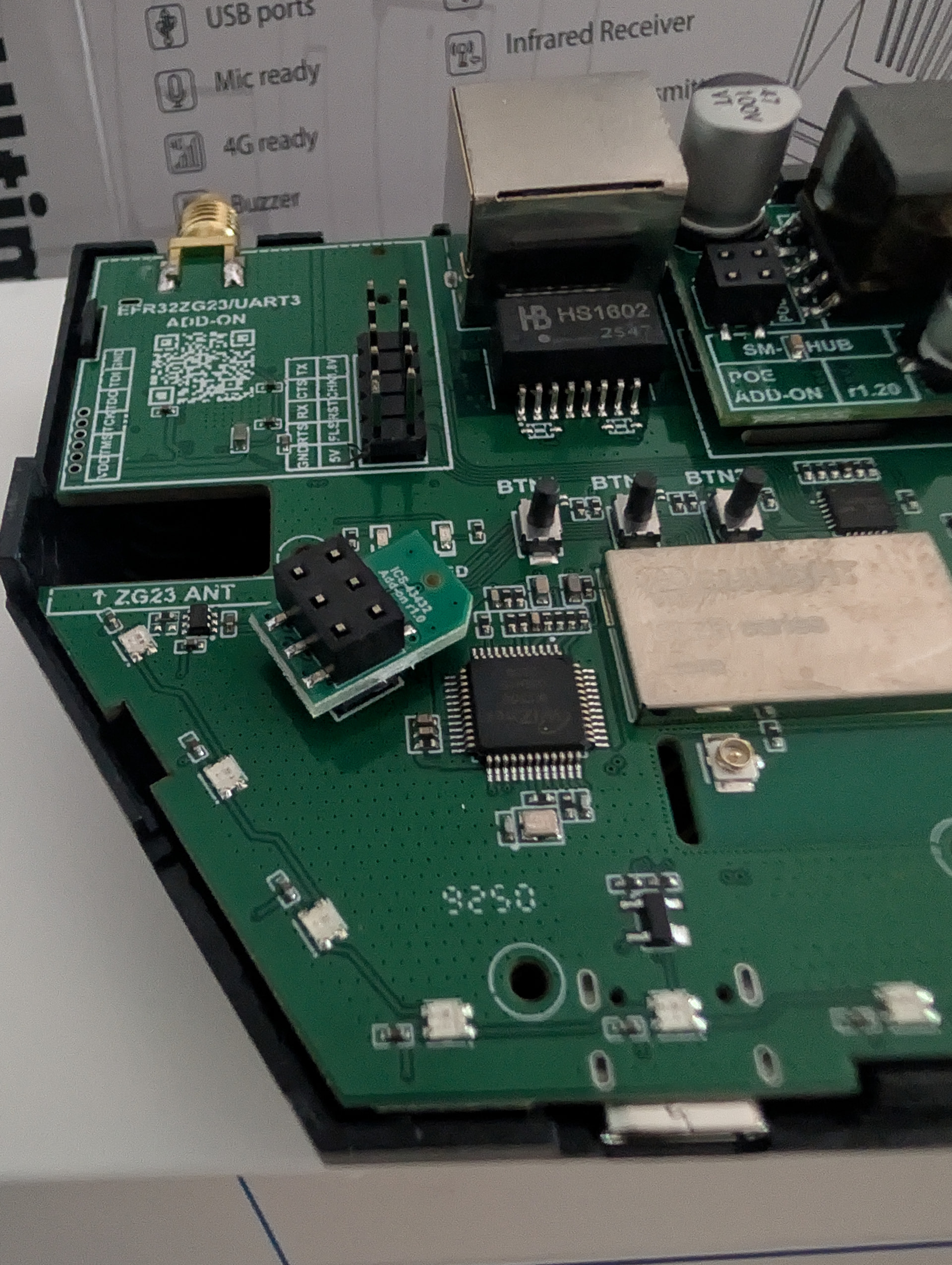

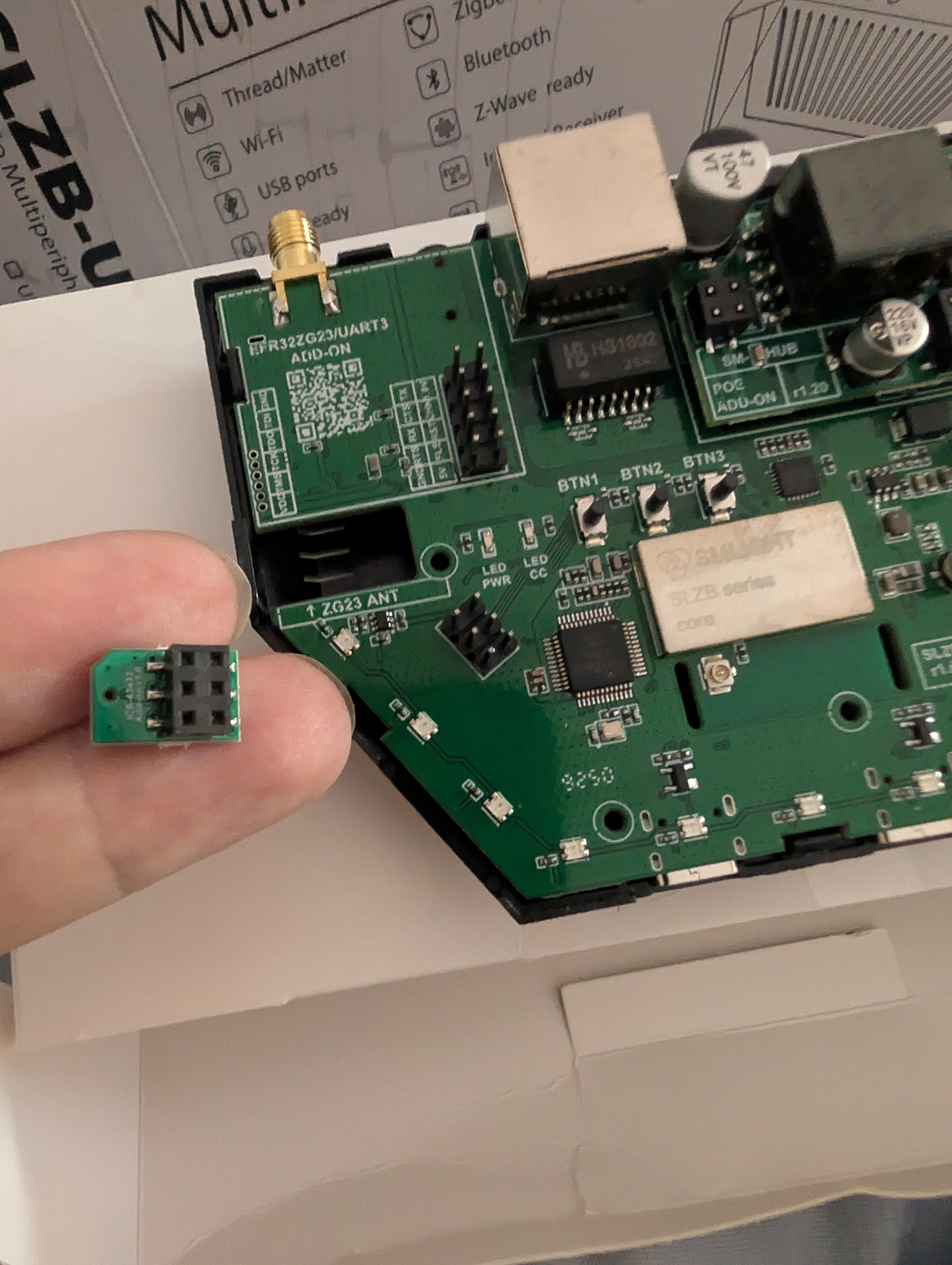

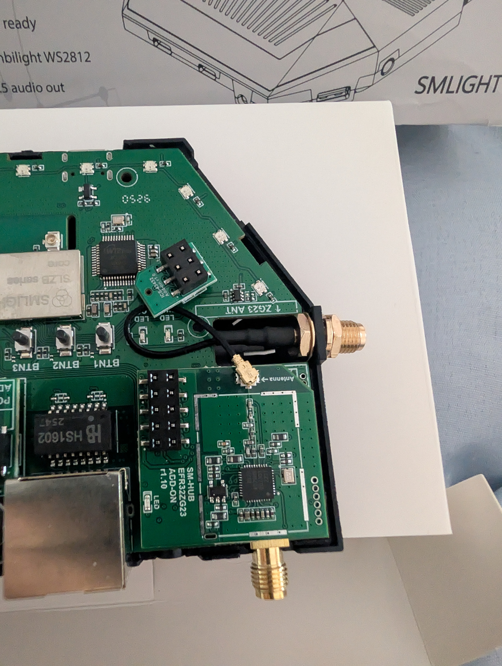

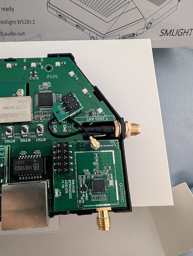

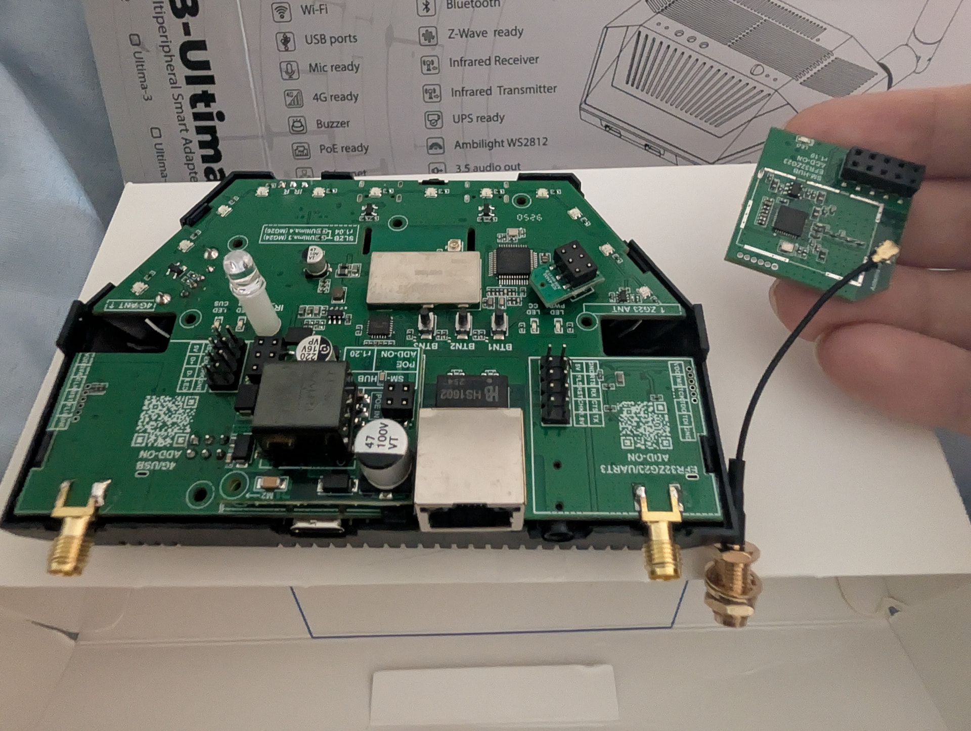

Device and component
in the todays firmware apears that a rf module is available for ultima. but i dont find information about this posible addon. do you find any information?
