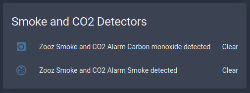

Have you looked at the Zooz Zen 55 DC Signal Sensor. It ties into to the series of smoke and CO2 detectors and interfaces via z-wave. I have this on my dashboard and they can be tied into automations.
The device ties into the last smoke /CO@ detector in the series. Wiring is simple.

It ties onto the last smoke detector in the chain and monitors the common line for communication. All of my smoke/CO2 alarms are scheduled for replacement in 2027 and I don’t have to buy anything special just replace with like kind and I am good to go. Fulfills my mantra for Home Automation that things work without the home automation but HA makes the experience easier and more robust.
Yeah, I just looked up the product and the video on its page and this will do very nicely. Still only good for notififying when it goes off and not managing it, but the latter is a nice to have anyway and this feels more reliable to me than having an entire secondary device listening for sounds instead. And I can get both that and Zooz’s Z-Wave LR stick for about $100 total here in Canada. Definitely going to look into this when I get paid next.
