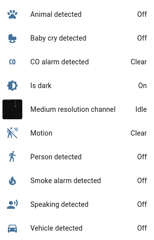

Another integration might be a Unifi camera (ideally external, but still in audio range) with the local processing of media on-camera.
The HA integration does support the sensor, but I’ve not tested the accuracy.

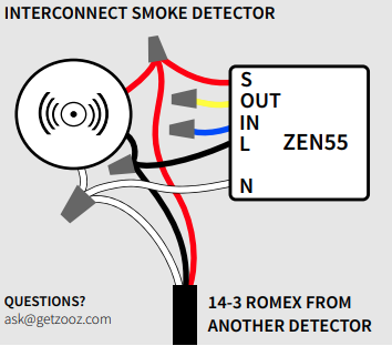

If you have Z-wave then definitely go with the Zooz smoke/CO detector. You don’t need dc-output. Just connect load, line and interconnect as per the drawing.

But if yours are all interconnected, it really is hard to beat the Zooz solution mentioned above... You just need to install one at one of the smokes in your interconnected network. Zooz's instructions say to put it at the last one, but that's just because the last box often has the most room it in -- it's perfectly OK to put the Z55 at any of the smokes.
