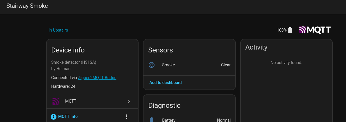

Finally with Z2M what activity is going on with the device. You are likely MQTT integrated, so go here and find the device:
Open your Home Assistant instance and show an integration.
Then when in the device watch here in Activity to see what is happening and capture that whatever it is.

The binary sensor is there. I couldn’t check events, yet. But I checked the sensor’s history and there’s nothing in there, it’s reporting that all is clear. Also I couldn’t see any activity.
