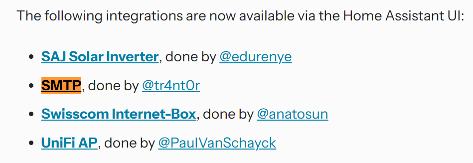

Read the Release Note , just search for i.e SMTP
( You will find the answer there )
2026.7: Automations that speak your language - Home Assistant .

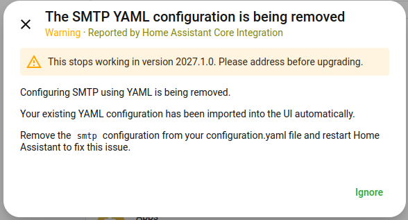

Just to make this a little more clear, because I initially was confused by this warning as well: after installing HA core 2026.7.0 this Repair can appear under Settings:
This means that when the SMTP notification originally has been set up in YAML, this now automagically has been converted to the SMTP notification setup in the GUI.
So the only thing to be done in this case is to remove the SMTP config from your YAML file, and restart HA.
All the SMTP settings that were set in the YAML file can still be seen and modified through the UI following: Settings → Devices & Services → Integrations → SMTP → click on the three dot button after the SMTP notify name and select Reconfigure.
This is better described than my attempt, the screenshot confirms the details
Thanks for posting this. Your message describes what the official notification should have mentioned.
