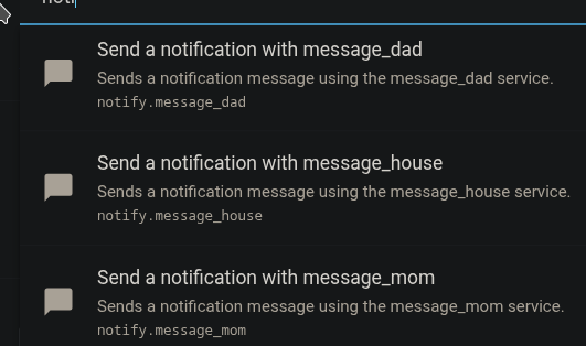

Well I can see my created notify actions from the that tool. Are you sure it is still in the right place?
Was it deleted somehow?
