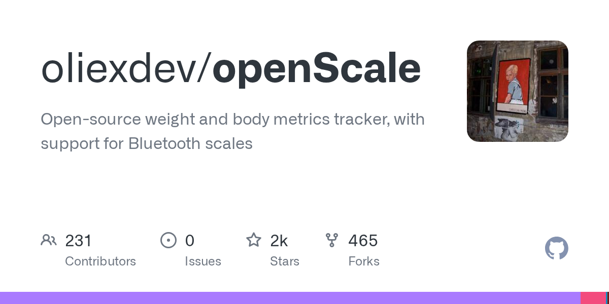

Just some ideas:
The Android app Openscale supports your scale and has been around for a while - I used it for many years. You may not have stumbled across it - your AI and LLM co-authors may benefit from being made aware of it for your updated version coding sessions and releases.
You may wish to cross-check the code on GitHub to see if you could benefit from their reverse engineering algorithm endeavours. In contrast to your ESPHome approach, it has MQTT capabilities that can inject the readings into HomeAssistant and supports a very wide, and ever increasing range of devices, most user submitted using their detailed guidelines.
Have a look at the mathematical formulas they use to derive related information such as body fat, water, and BMI that you might wish to add functionality to your app as derived sensors, or pre-calculate them on the ESPHome device where you already have the raw data - taking careful note of floats, double integers and the suchlike variable types. Be aware most of the authors of these formulas are Asian and their traditionally smaller body size can skew the figures, and may need adjustment for European and other nationalities to reflect reality. Read the medical background papers and understand how they arrived at the algorithm.
You may be able to broaden your app to support other scales too, based on the UUID listings, check-summing and data unpacking formats, as well as investigate other existing HomeAssistant HACS apps that also use BLE to read and decode data from other scales.
Look at functionality that offers tare/differential readings useful for weighing babies and pets, where the combined weight has the individual weight subtracted to arrive at the final result - a two step process, as well as supports different individuals, recognising them by their existing recorded weight. Best prompt if two are similar and let the human choose.
Be aware that a lot of BLE devices only (by design) support ONE session at a time. This may cause unexplained disconnect and error messages if you are not aware of this, and attempt to use your phone app and ESP32 simultaneously. Ask me how I know… :wink:
Stand on the shoulders of giants.
Hope I have given you some ideas to work with. Looking forward to your expanded app…
