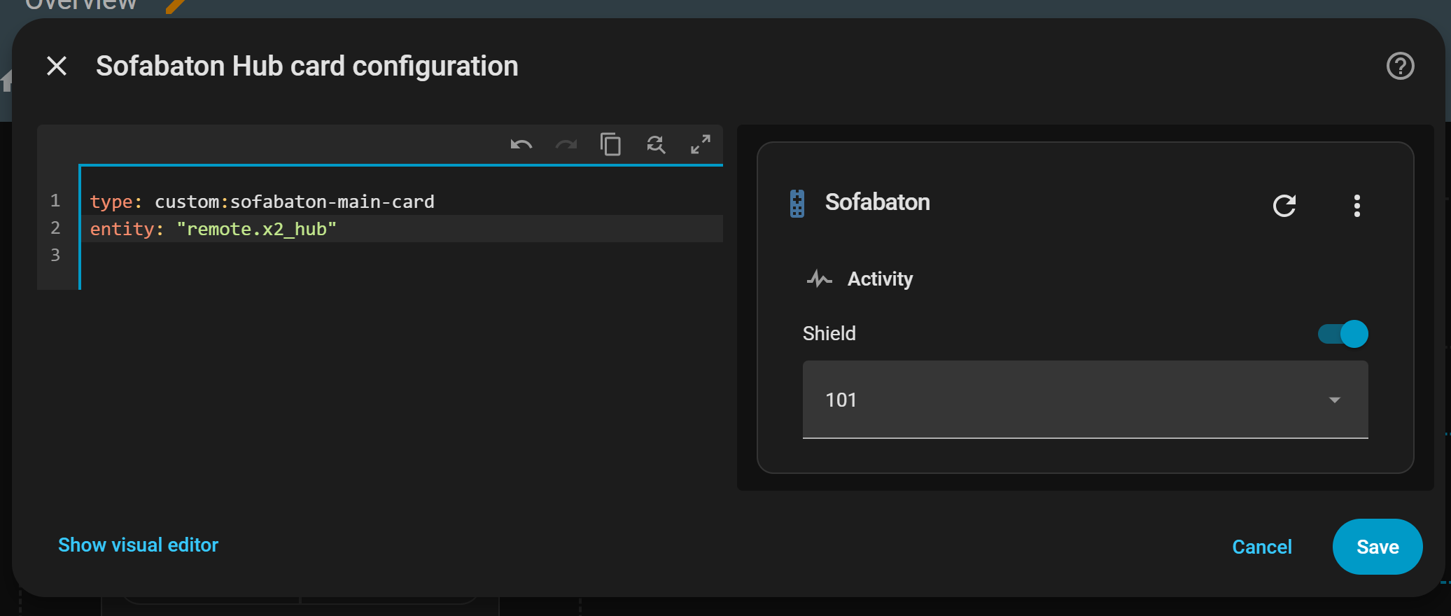

Thanks this is great so I have everything setup, item I’m wondering now is went into HA and the Sofabaton Hub Custom Card is now showing activities but has this 101 in it for some reason.
Any thoughts where the 101 is coming from?
Should also mention that the XBox 360 is first in my Activities and the Shield second so not sure if it’s sorting in the pulldown.
The hub uses internal IDs for all Devices, Activities, commands etc. The IDs for Activities start at 101, so fairly sure that this is where the number is coming from. Are you missing any Activities, or do you just have the 2? This issue will go away for sure if you do any of these things:

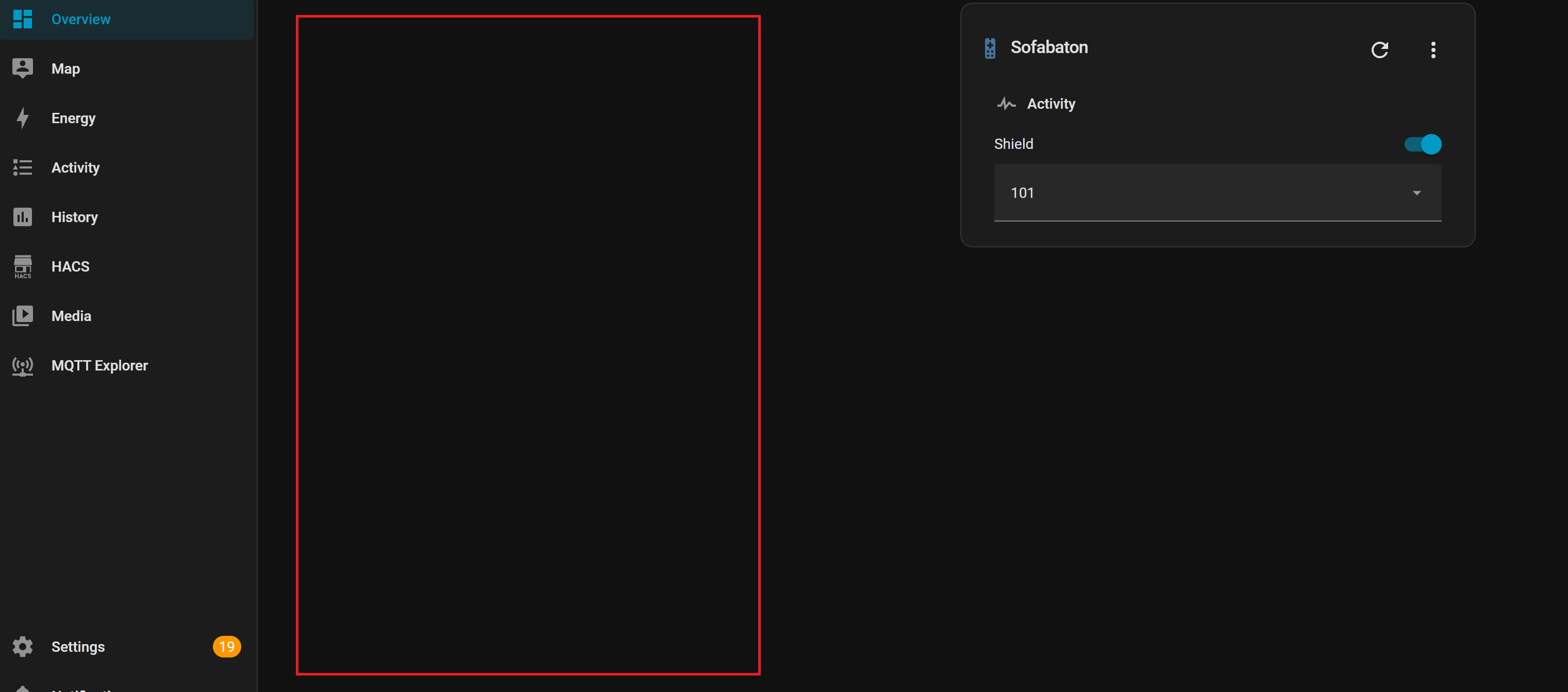

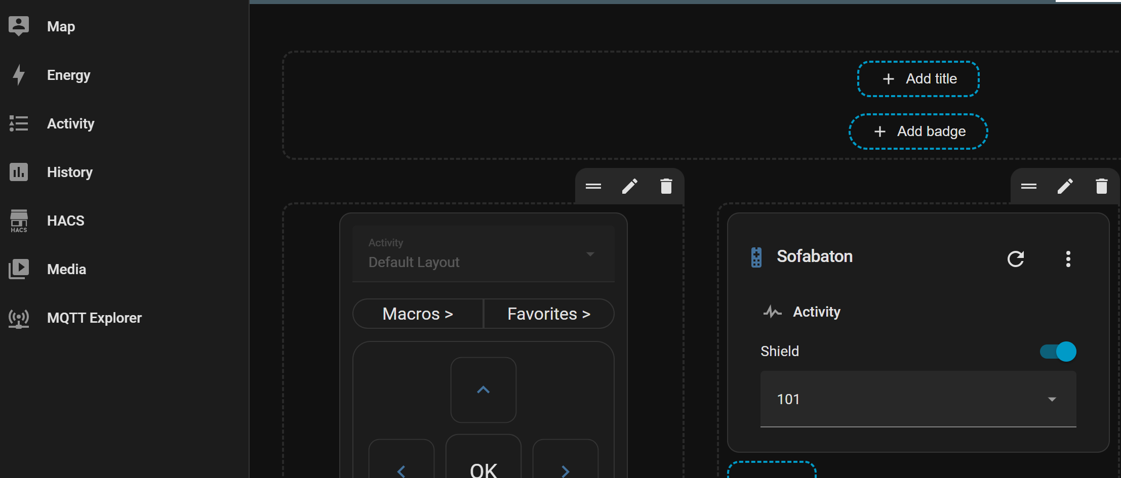

@m3tac0de Just want to say thanks for that keyscraper script. That’s been the most helpful thing I’ve found while setting up my automations that used to send via Harmony. Copy/pasted the resulting notifications and I have a super-handy way to grab the code for sending a remote key. Thanks so much for this.
I do only have the two. Funny you should ask about the virtual remote. Seems neat but has a bug. So I see it in HA on the phone however on my Windows laptop when I save everything it goes away.
If I edit then it shows up
JR

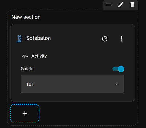

That’s not good @jriker1, i’d like to fix it. I imagine that it has to do with the incorrect Activity state the Sofabaton Hub integration is showing in your screenshots (the “101” makes no sense).
Have you been able to resolve that issue, does that Activity dropdown now show the right Activities? If the Virtual Remote card is still not working, please press F12 on your keyboard when the card is in a faulty state. This will open the developer tools of your browser and towards the bottom it will show you the console. I would like to see a screenshot of that.

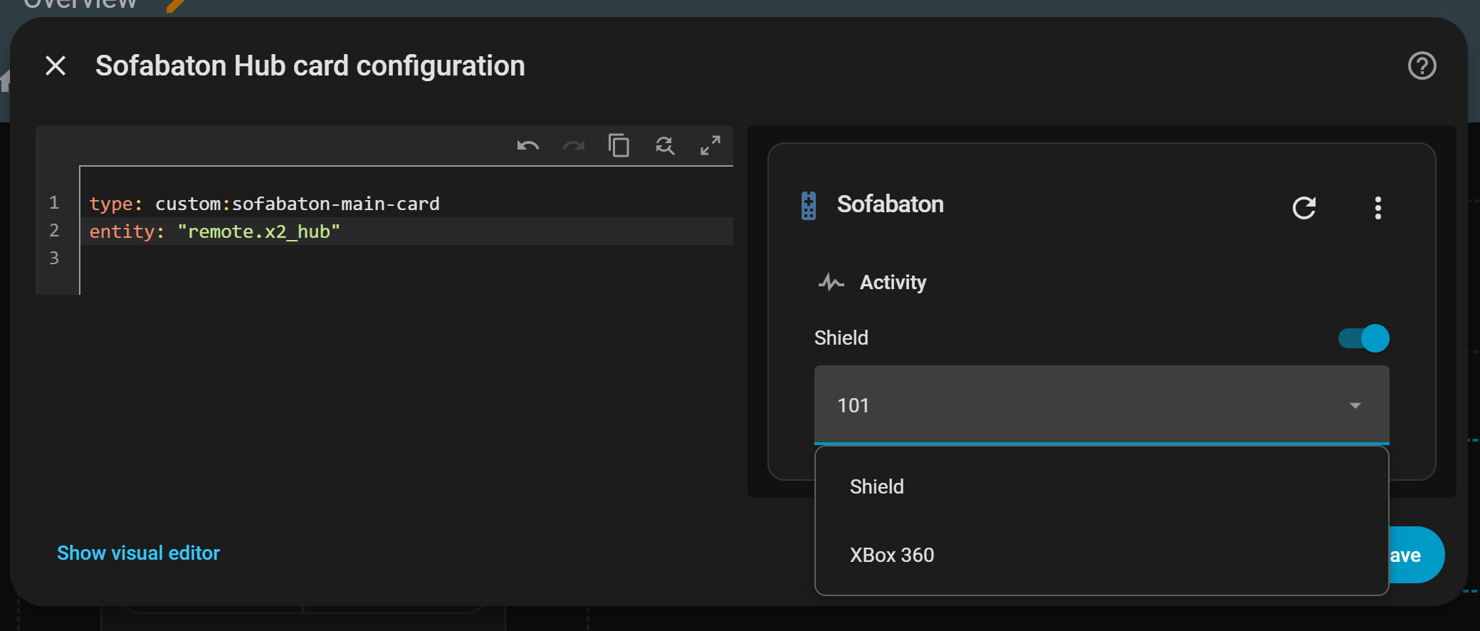

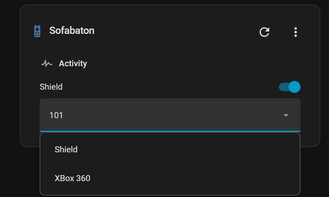

OK let me add it back in. So when I try and add that card I can’t select the hub which I had that issue last time.
When i try and “click” on it it doesn’t like accept what I clicked on and stays with the full pulldown. I have to go to show code editor and manually enter it.
As you see it’s still showing the 101 but the other two are there in the pulldown.
I add the card now and I have the Shield running at the time. It still says 101 but shows the Shield Activity is on.

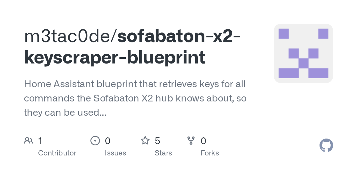

Wonderful instructions, thanks. However, I can't seem to find the key codes for the numeric virtual keys (1,2,3,4, etc) that my TiVo activity uses. The Sofabaton device's virtual keypad doesn't include the numeric keys, so I can't select 1, 2, 3 to see what the code is in the logs.
try this @vahighland
It's a blueprint for a script that when you run it returns all ids for a device or activity.
Thx, I’ll try that

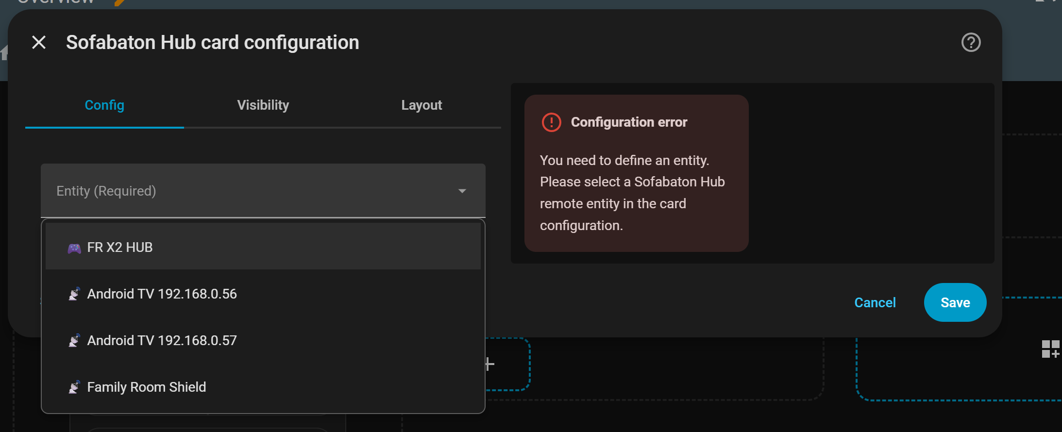

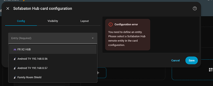

Has anyone installed this offical integration recently and got it working?
I’m making the switch from harmony elite - which worked fine in HA
I have MQTT installed, the integration installed, but the official sofabaton card doesnt seem to work properly
when setting up the new card, I can see my hub in the drop down entity list but it wont allow me to select it.
If I enter the hub entity in the card YAML then it populates the card dropdown with my activities but I am also unable to select an activity - if I click on a dropdown option it will not register as selected
If however I find the activity entity through settings and flip the switch, it works fine
So there appears to be something weird going on with the sofabaton card.
Unfortunately there does not seem to be much development activity on the official integration.
Any help appreciated
cheers
Not really an answer to your question, but when I set up my X2 in Home Assistant, I found the SofaBaton X2 Library Scraper blueprint to be super handy. When you run it, it’ll generate persistent notifications with the activity IDs, device IDs and key IDs for everything. Copy that into a text file and keep it handy when you build automations/scripts.
Hello @wazza_c12. Are there any errors in the Home Assistant log?
There are some issues with the MQTT implementation on the hub and with the integration itself, but those issues can be worked around for the most part.
  • The hub frequently fires its MQTT “activity changed” update BEFORE the internal state of the hub has actually changed. When the integration immediately responds to the changed update by retrieving a fresh list of activities, while the hub is still in an intermediate state, state corruption can occur (the integration is showing you hub state that doesn’t match actual state)
  • The integration has 2 triggers for retrieving fresh information from the hub. In certain edge cases, these compete (a race condition) and may deliver incorrect data to the user.
  • The hub is unable to return larger datasets over MQTT, consistently. Additionally, it appears that each time it fails, there is some type of residual effect that progressively impacts the performance of the hub.
Things to do:
  • Reboot your hub and once its back up restart Home Assistant. This may resolve your immediate issue.
  • As we wait for official updates to firmware/integration, I have a fork of the official integration sitting in my repo that addresses and works around some of these issues (it cannot fix the large dataset issue). The fork is here.
  • You could potentially try this alternative remote card for your X2 hub and see if you get better/different results.
  • You could potentially try this alternative integration that works with your X2 hub. It can co-exist with the official integration.
