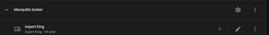

I see only the Entity in Home Assistant that is an Axpert Inverter. Not more

What are you using SA on? I have SA on Rpi4 and I can see all entities via MQTT in HA.
Do you have it in your configuration HA?
/share/mosquitto/solar_assistant.conf
connection SolarAssistant
address 1xx.1x.x.xx
topic # in
topic solar_assistant/# out
