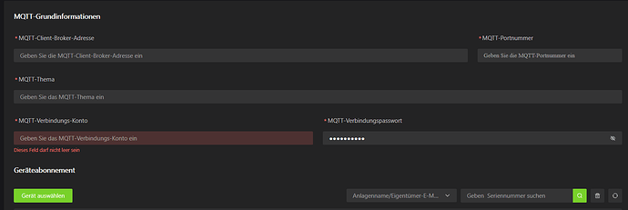

Hi guys,

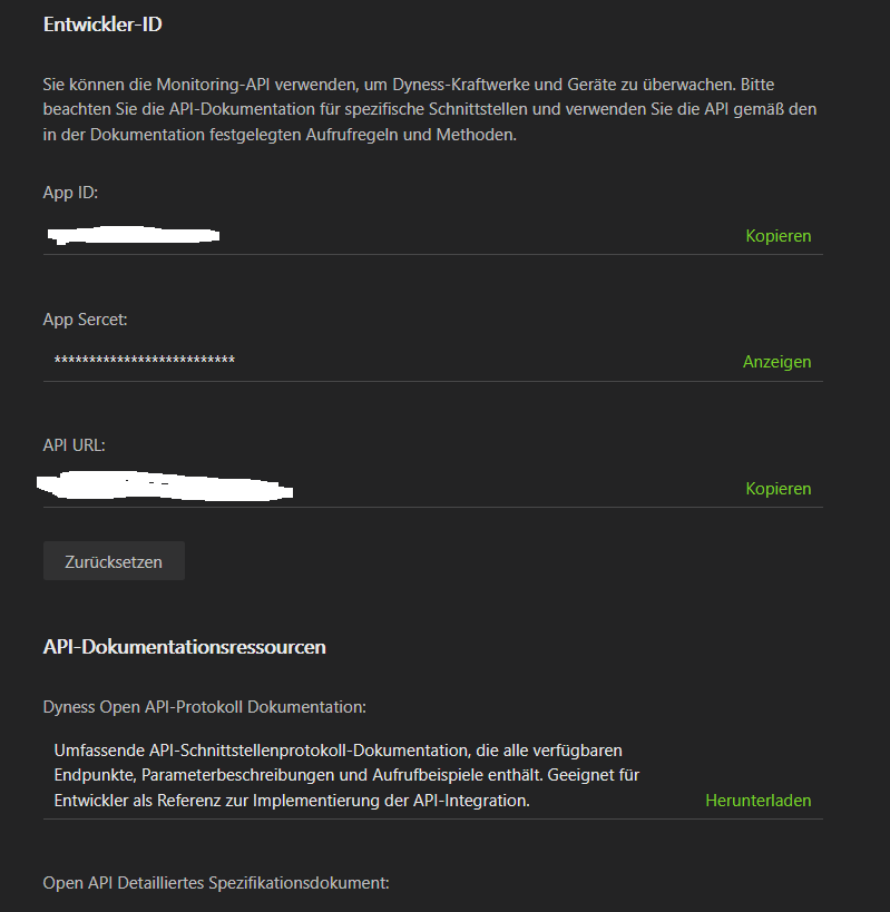

I have a battery storage device from Dyness. I’d like to integrate it into Home Assistant to read the data (battery status, etc.). If I understand correctly, it’s all cloud-based. On the Dyness monitoring page, I saw the following: Under Developer Center, there are two submenus: API Management and Data Forwarding (MQTT). Can anyone help me with the setup? Or is anyone already using it? Thanks a lot for your help.
Mqtt:
Api:
api :https://web-static.dyness.com/doc/DYNESS%20Open%20API%20interface%20protocol%20document.pdf

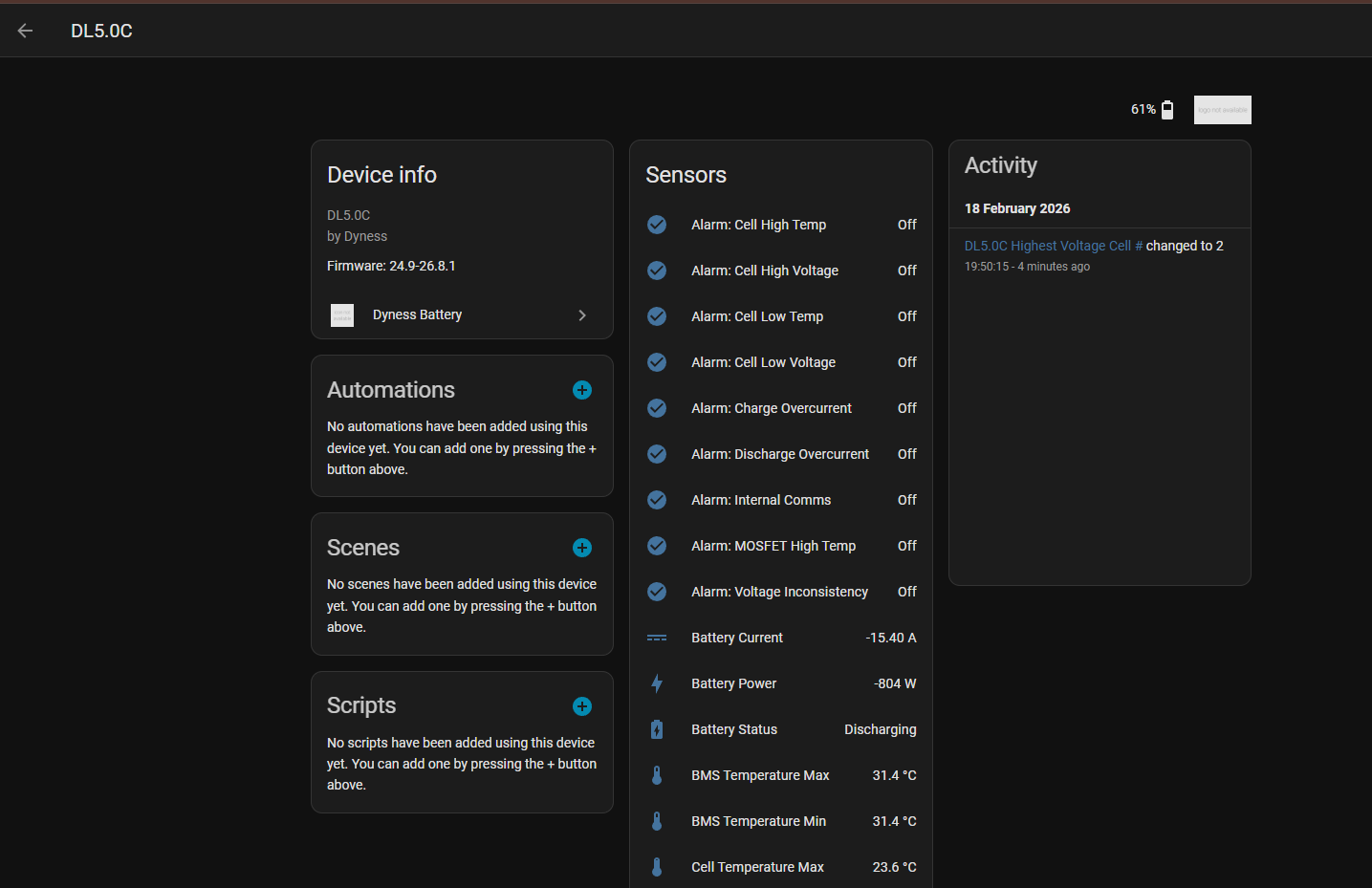

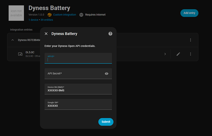

Hi. I worked up a solution. I must admit I have limited coding experience and used help from AI. Developed a custom component that polls this Dyness API. In my case, the API URL is (http://open-api.dyness.com) global/European API for Dyness DL5.0C. I do have a universal version, but no way to check it. Attaching a zip folder. There is a readme inside, please make sure to follow that and let me know how it goes!
Link to ZIP Folder: https://drive.google.com/file/d/1FyL6uYLqsDHlWSV3zQ17eiFXscgIA2xo/view?usp=drive_link

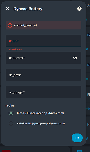

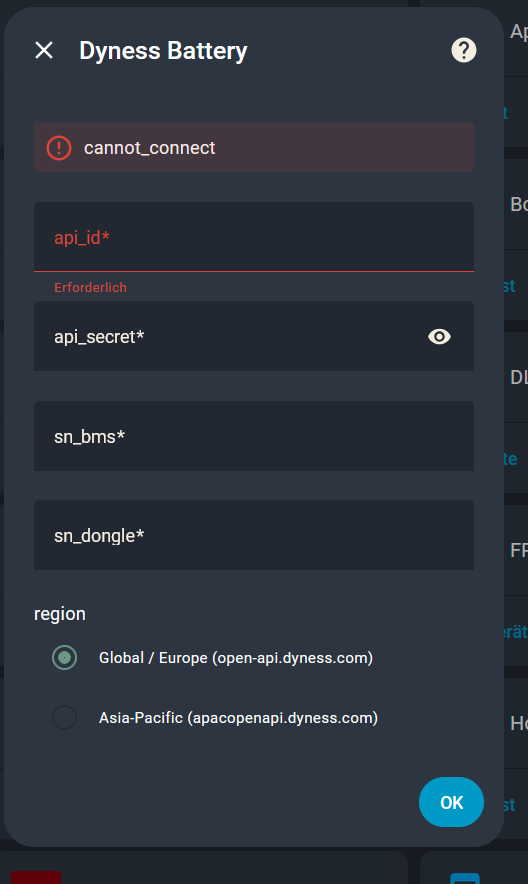

Hi, I’ve followed all the instructions in the readme. Unfortunately, I can’t get a connection (see photo). I’ve also updated the API again, but without success.
Do you perhaps have any other ideas?
Do I need to do anything else in the Dynes interface? I’ve already activated the API and I can see the values. I have the feeling it’s not establishing a connection to the API.
Do I need to subscribe to anything else in the Dyness Portal, or anything like that?
Did you select the right API Url (region)?
Try both

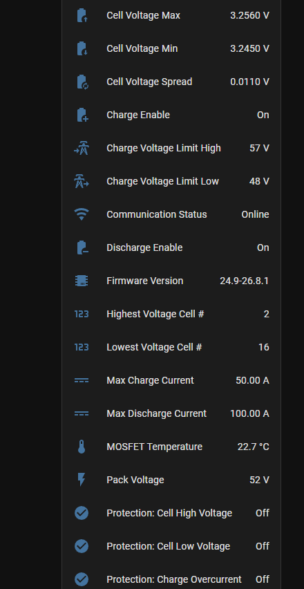

Available sensors:
  • State of Charge (%)
  • Power (W) — positive = charging, negative = discharging
  • Current (A)
  • Battery Capacity (kWh)
  • Installed PV Power (kW)
  • Communication Status (Online/Offline)
  • Work Status (e.g. RunMode, StandBy)
  • Firmware Version
  • Last Update / Data Timestamp

  1. Make sure your API credentials (App ID and Secret) are correct — they can be found in the Dyness portal at ems.dyness.com under Developer Center → API Management

  3. Make sure the device serial number (deviceSn) and collector serial number (collectorSn) are correct — you can find them in the Dyness app under device details
During setup the integration asks for deviceSn and collectorSn — did you enter both correctly?
  • deviceSn: the serial number of the BMS (e.g. R07E8546681A00F9-BMS)
  • collectorSn: the serial number of the WiFi dongle (e.g. R07E8546681A00F9)
If you are unsure about your serial numbers, you can use the included test script tools/dyness_test.py from the repository. It will help you identify your device and collector serial numbers.
