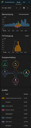

Yesterday it looks more correct than today.

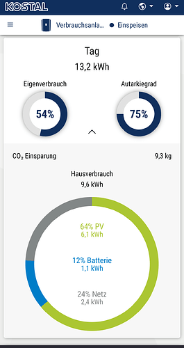

Today the consumption should be 9.6kWh.
6,1 kWh directly consumed from the Solar panels.
1,1 kWh from Battery.
2,4 kWh from grid.
This data is from the Hybrid Inverter that has the battery connected.

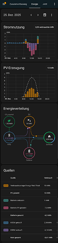

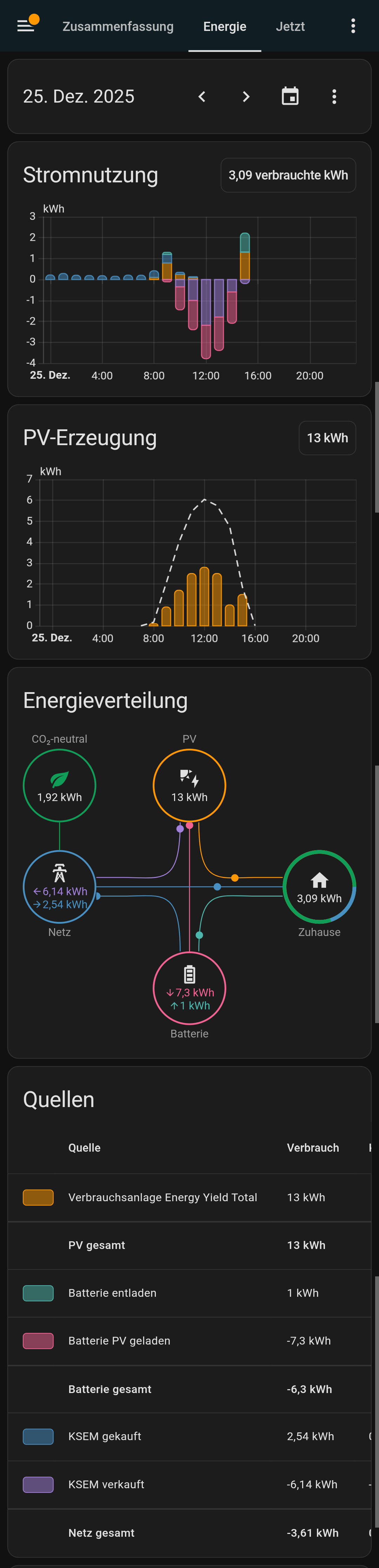

But the Dashboard shows only 3,09kWh complete.
