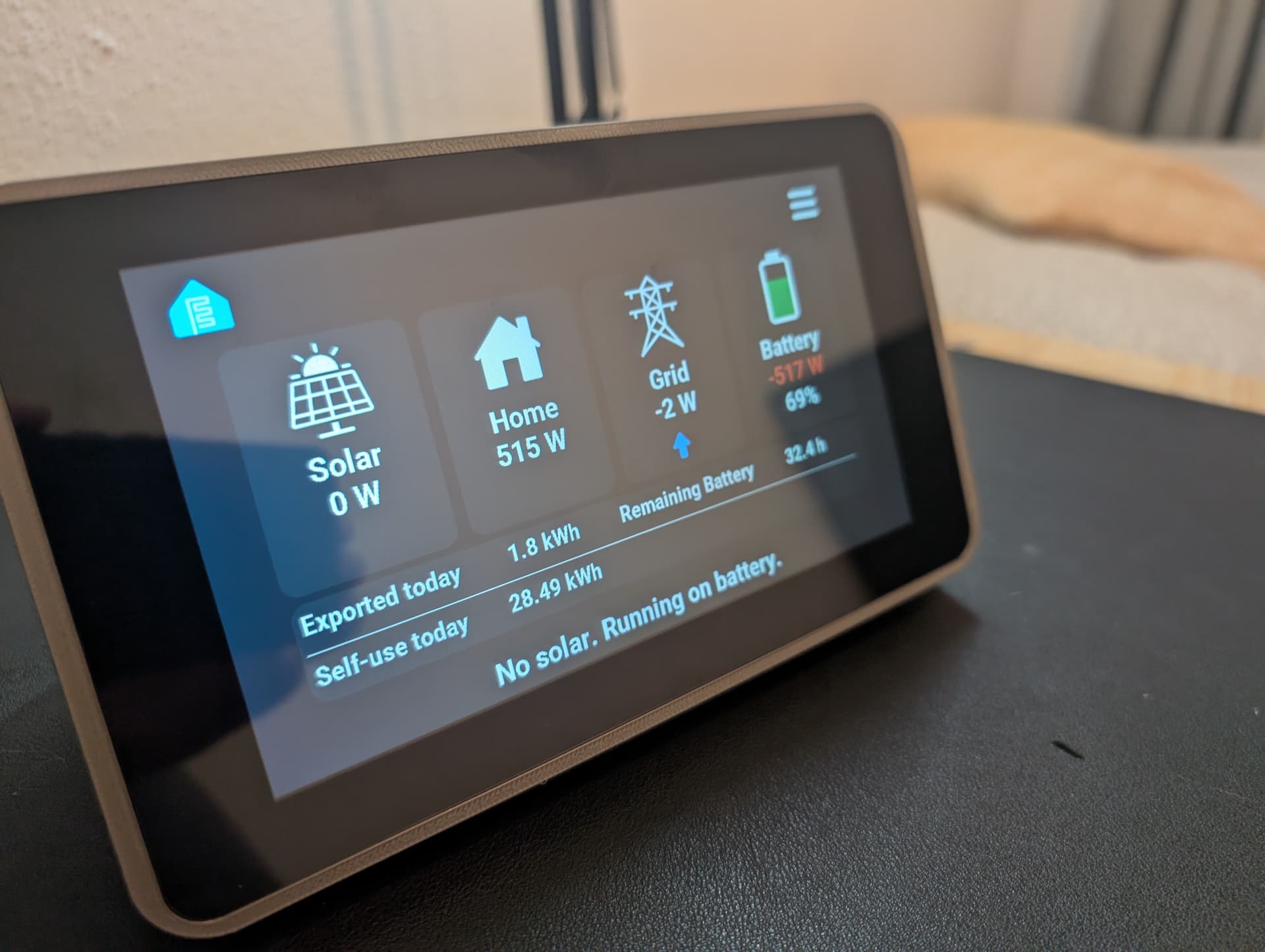

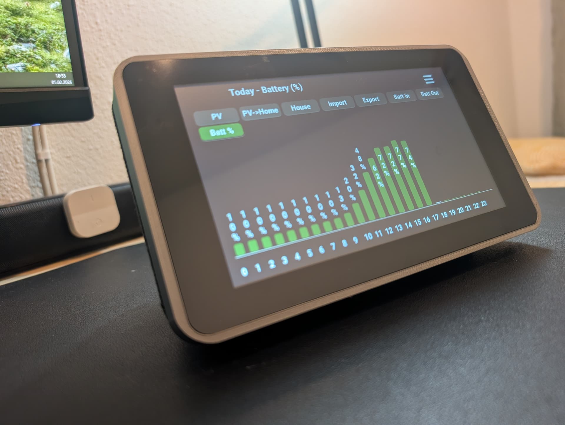

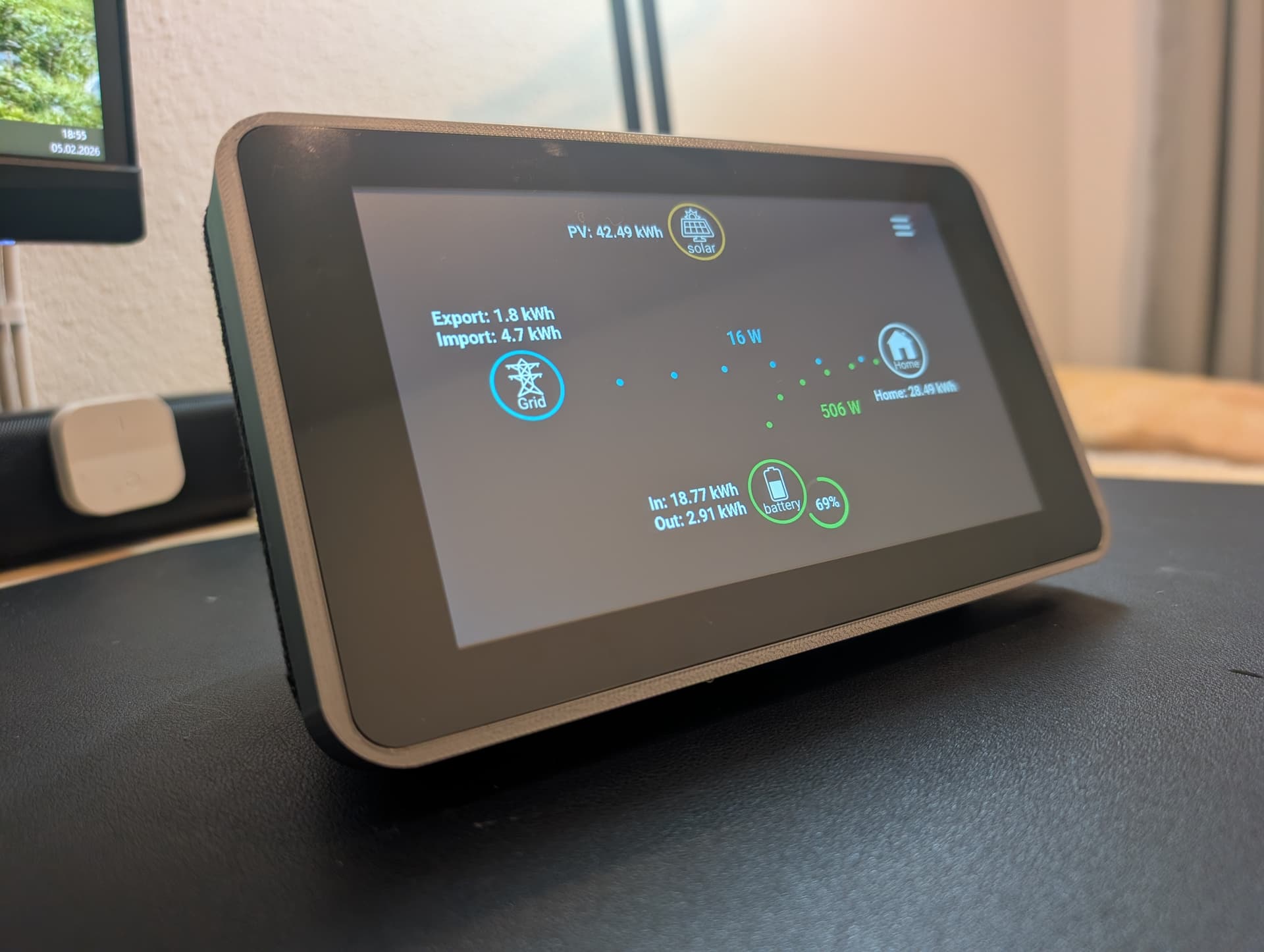

Hi, Over the past months i have been working on this solar display,
currently it supports solaredge and sigenergy.
want to add more features in the future and clean it up, also currently only works with esphome 2025.10.0 atleast on the newer version the display is buggy.
please let me know what to add, and how to improve as this is a first.
take a look on github for more info

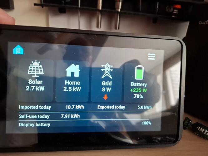

I have it now stil busy to get every thing working a have Solaredge system with battery(2 pylontech us5000 battery (its working with the rws version inverter as a byd-lv 10.4 battery) and also the solaredge meter. i use esphome 2026.2.0 on pc to program it.
i had to change a lot in solar-display.yaml slowly i get the most working now.

I use the solaredge 10k-rws inverter also for the pylontech us5000 battery’s.
By the way i have also now a guition esp32-p470C-I-W running with the same in info had to make a few change to solar-display.yaml for it still busy with it to get also the info from the displaybattery that i have get it working on de esp32-s3 display i also changed the new home display but i want to change more to get all info one one screen. I use Esphome 2026.3.2
