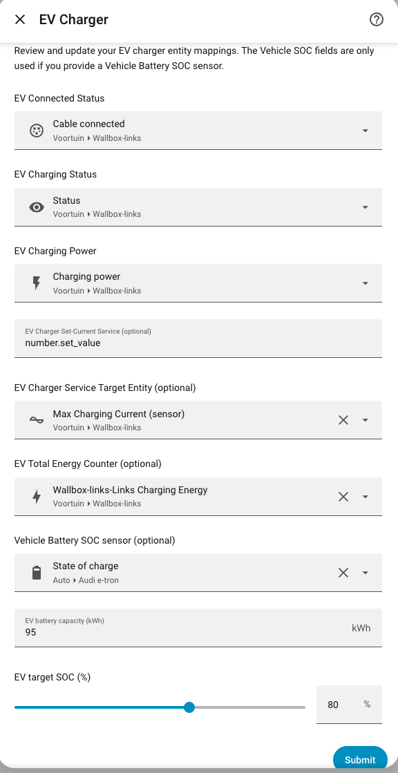

As you know I have 2 Wallbox Pulsar Plus chargers
See screenshot below. Do you think this works for setting the charger max amps
There is no specific service call for the wallbox.
Hi @RienduPre! Great to see you here too — we’ve been working on your GitHub issues.
Yes, SEM can control your Wallbox Pulsar Plus! The latest beta (v1.4.2-beta.1) adds support for chargers
that use a number.* entity instead of a service call:
  1. In SEM options → EV Chargers → Edit your charger
  2. Set the Current Control Entity to your Wallbox’s number.* max current entity
  3. Leave the “Set-Current Service” field empty
SEM calls number.set_value on it to dynamically adjust charging current based on solar surplus.
Multi-charger is also supported — add your second Wallbox via the charger menu. Each charger gets its own
sensors (sensor.sem_charger_{id}_power, _session_energy, _session_solar_share) and SEM distributes surplus
by priority: highest-priority charger gets power first, remainder flows to the next.

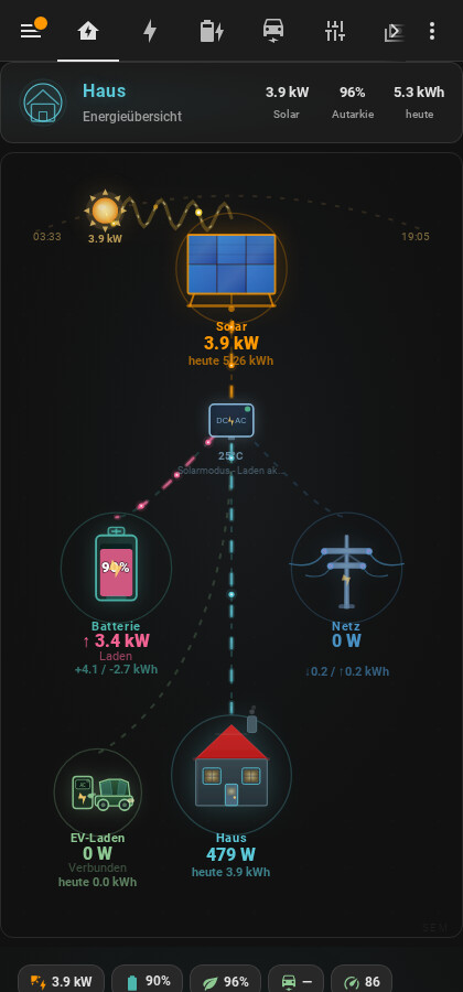

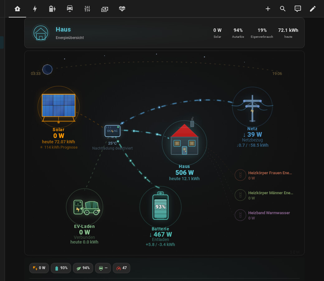

:sparkles: Illustrated System Diagram (v1.5.7)
The Home tab got a complete visual overhaul. The old abstract circle-node layout has been replaced with detailed SVG illustrations for every component:
What's new:
  • :house: Illustrated components — solar panels with cell grid, house with glowing windows, 3D battery, transmission pole, EV charger with car silhouette
  • :sun: Sun arc with real-time position — tracks from sunrise to sunset, moon + stars at night
  • :ocean: Golden sine wave particles — energy flows from sun to panels, speed scales with production
  • :high_voltage: K-Flow-inspired spark animations — 3-layer glow flow effects on all energy paths
  • :artist_palette: SEM color scheme on flows — pink battery charge, teal discharge, purple grid export, blue import
  • :mobile_phone: Responsive — desktop (left-to-right) and mobile (vertical stack) layouts
  • :backhand_index_pointing_up: Clickable nodes — tap any component or value to open HA statistics
  • :electric_plug: Individual devices — top 3 devices by power consumption shown on desktop
  • :bar_chart: Solar forecast shown directly on the solar node
  • :counterclockwise_arrows_button: K-Flow option — prefer K-Flow? Set diagram_style: "kflow" in config options
Mobile view:

I’m having a problem with the installation. The SEM installed successfully and detected many sensors, but unfortunately, it didn’t detect the “go-eCharger” EV charger. The go-eCharger sends its data to an MQTT server, from which HA reads the data.
I can see all the entities in HA.
However, SEM isn’t detecting the go-eCharger; instead, it has registered a “dryer” energy meter.
How can I register the correct EV charger?
