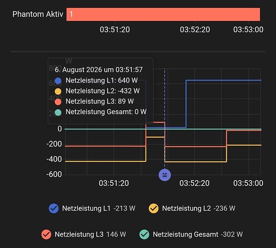

Look at that snapshot from my Home this morning, while the coffee machine was running. Battery serving the house…
All 3 phases sum up to
+640W + (-432W) + (+89W) = 297W
But only for 1 or 2 measurement cycles. Anyhow, during the day all those little and short values sum up on the energy meters.
Most likely your inverter app and the integration calculate those conditions differently, if at all…
If you only use a polling interval in the range of seconds, there is no good way of filtering.
As the inverter needs the home electricity data, you probably got a smart meter installed as well. I have got an Eastron SDM630 in my electric cabinet that is connected to and polled by the inverter every 280ms via Modbus. I just hooked a Waveshare RS485 TO ETH in between to read this communication. On such high frequency I can do statistics and only give sensor values to HW every 15s.
Here is my extremely well working Waveshare sniffer…
Main principle:
  • check for the signs on the 3 phases. Equal means real power flow. Sum over the phases indicates that as well and shall be around 0 for no power flow
  • average P total about 1 minute (4 measurements) → if in 15s I have 297W and next 15s it shows -300W that cancels out. Most likely no real power flow
  • take the min of P-total and phase sum
  • below a threshold → rate it as phantom power and stall the energy meters
Instead of some kWh difference per day I now have got between 0 and maybe 0.1kWh difference, compared to the physical meter from my electricity provider. The script is never going to be perfect but what in life is?
