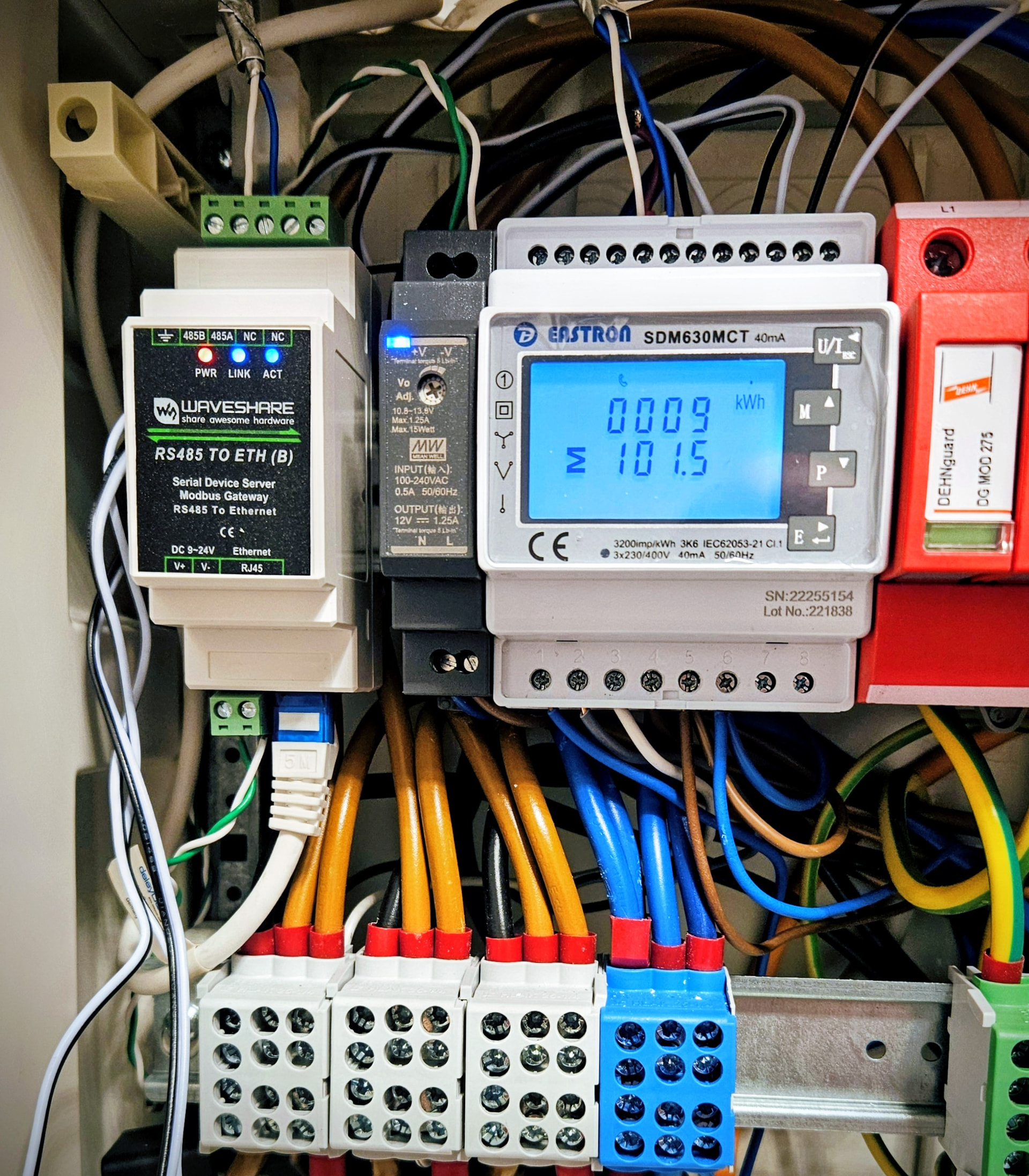

In my Installation an Eastron SDM630 (which gets each phase current from CT clamps) was installed into the electrical cabinet to serve the inverter with grid and house data. The inverter is the RS485 master polling the Eastron for data very frequently - ca 280ms for all power related and ca 1.7s for all other measurants. I think, this is not an uncommon way…
I just installed a Waveshare RS485 TO ETH in between to sniff the data and make use of it.
This is, how it looks like:
The good thing with such frequent data (especially power with more than 50 samples in my 15s interval) is, I keep them in a buffer, trim out the 10 highest and lowest values and average the remaining 30+ data sets by a pyscript until the final result is given to a HA template sensor. I wouldn’t get such control of data processing capabilities with a Shelly. And I have got several Shelly’s as well…
