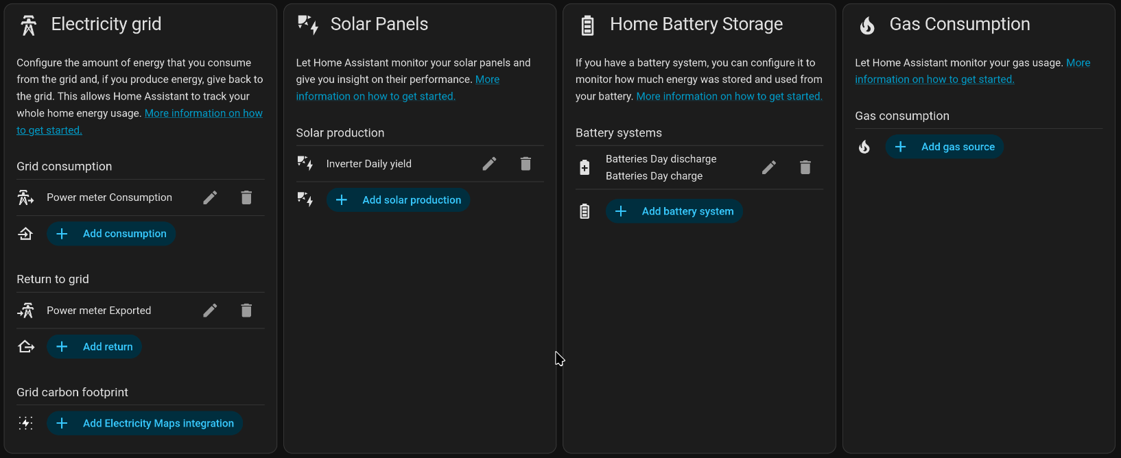

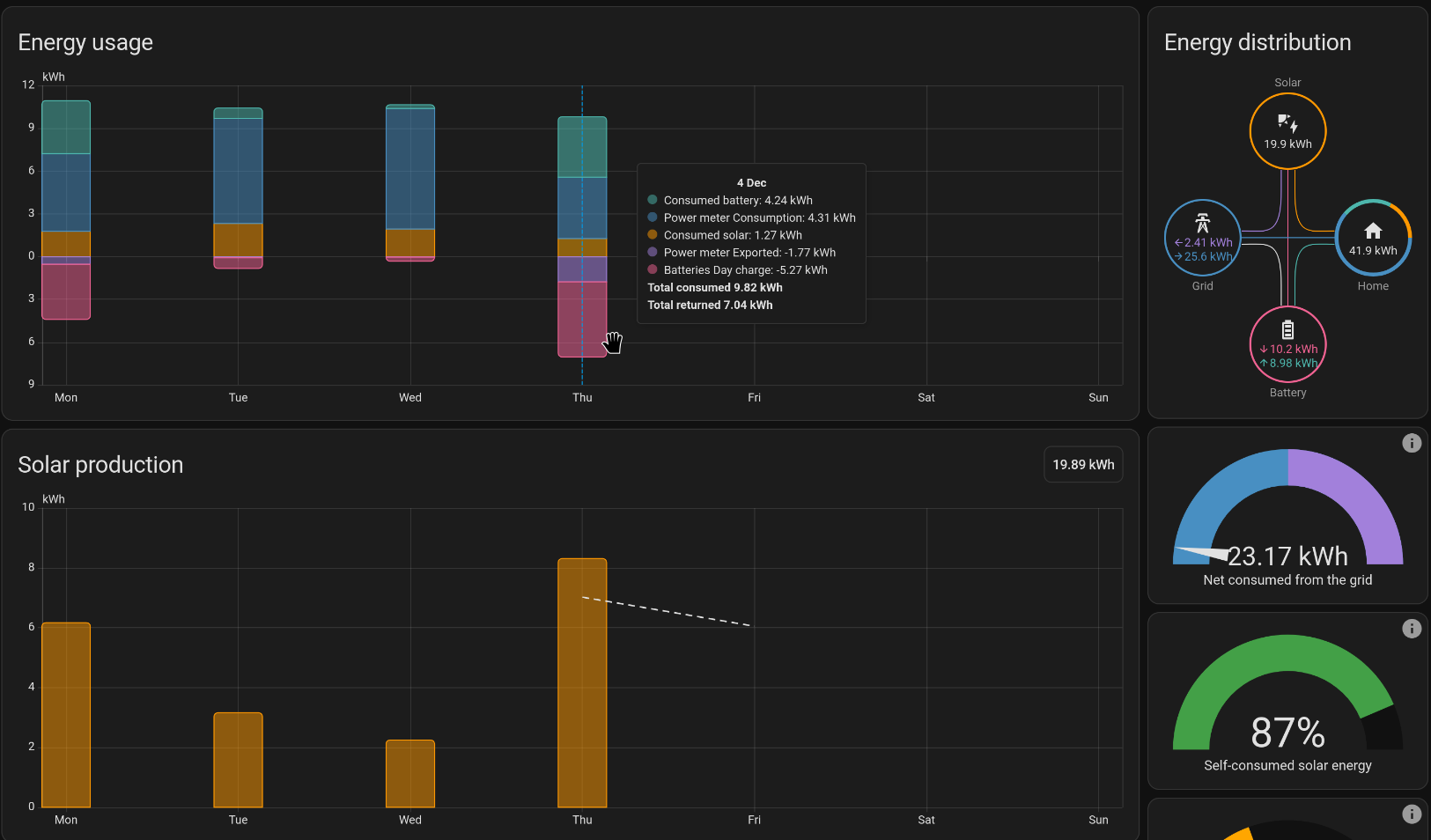

So I have this Huawei SUN2000-5ktl and LUNA2000-10kW-C1 battery and I am getting some weird readings:
The house did not consume that much energy from the grid and that wasn’t how much the PVs produced.
I think I am missing something but I don’t know what.
My guess is - the Energy Dashboard entities should ideally be total-increasing, that is, they should be the total solar, grid, battery charge, battery discharge [since the device was first turned on].
These figures then always only ever increase, and Home Assistant does the work of partitioning into days.
If you use the daily-figures, then you are relying on the inverter resetting them every night at just after midnight. If the reset happens too early or too late, then it conflicts with how HA works and the figures get messed up.
Your inverter / integration should provide a figure for total solar (ever), but if not then you will need to set up a utility meter to replicate a ‘total-ever’ counter.
trying it now!
Not sure I am selecting the right sensors.
Nothing seems to corelate with the Fusion Solar app.

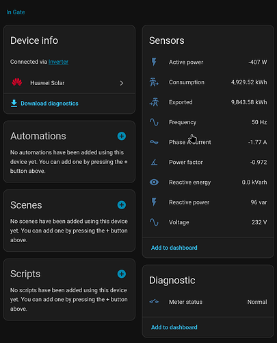

Grid consumption: Consumption 4949.52 kWh
Return to grid: Exported 9843.58 kWh
Solar production: Total yield 13,889.44 kWh

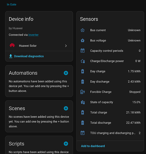

Battery charge: Total charge 21.18 kWh
Battery discharge: Total discharge 22.47 kWh
all look like plausible sensors, on the assumption that you have been running solar for some time and only just added a battery to the inverter…
