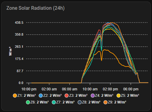

Here is a chart of the solar radiation it outputs across my 9 sprinkler zones throughout the day:

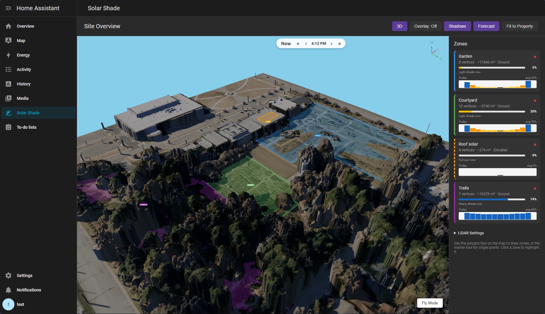

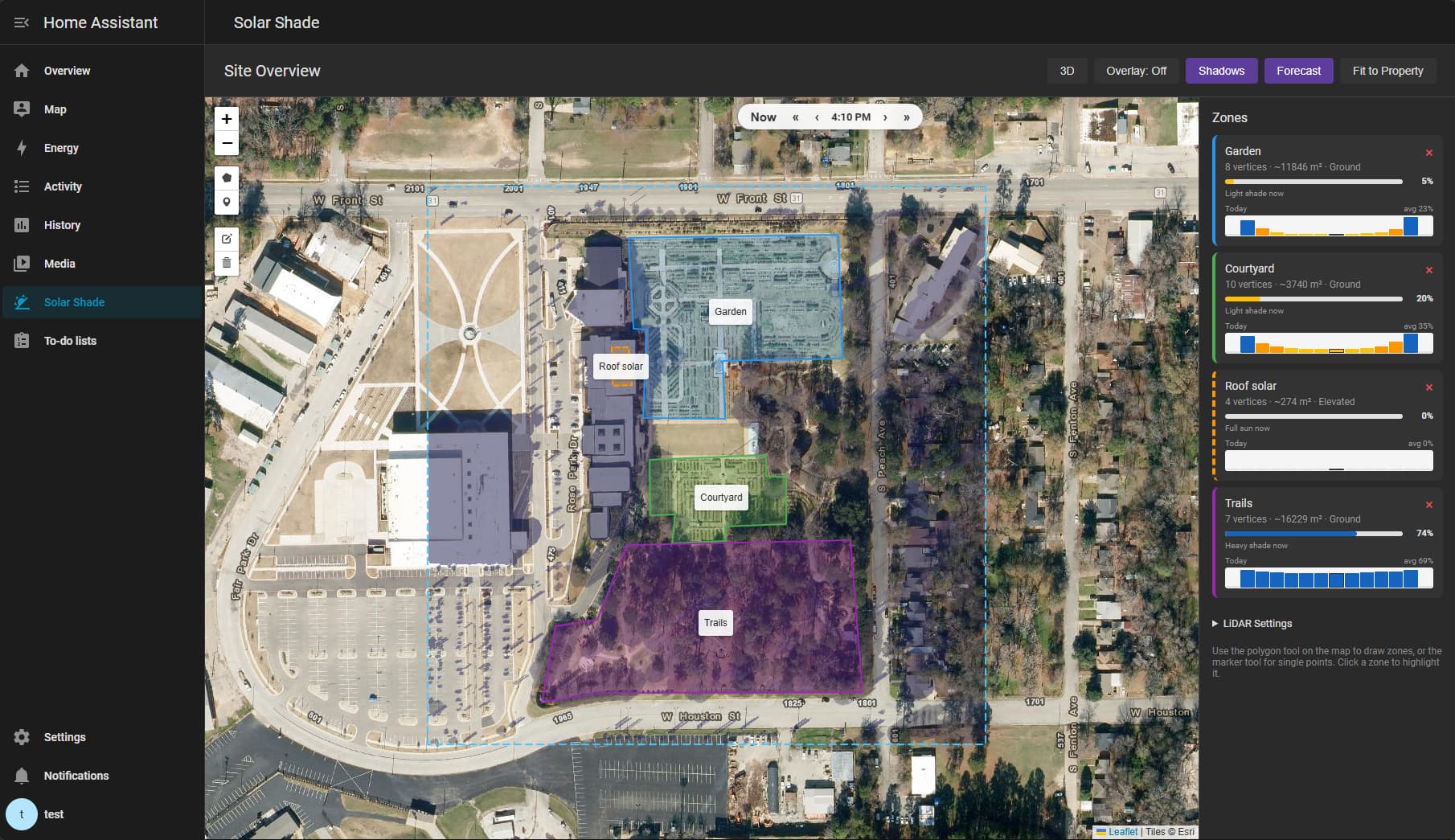

Here are a few UI screenshots showing how it is setup and looks. You can draw a polygon or point on the map to create a zone:
It has different visualization modes to better investigate the LiDAR data. Not all areas have as detailed of coverage as my example.

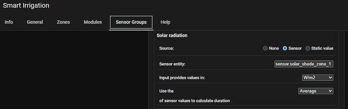

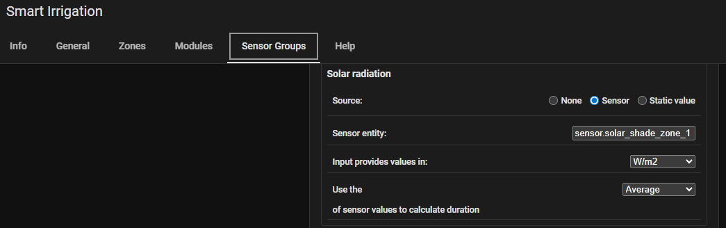

For anyone else wanting to link it with Smart Irrigation, you simply add the output sensor to a sensor group:
