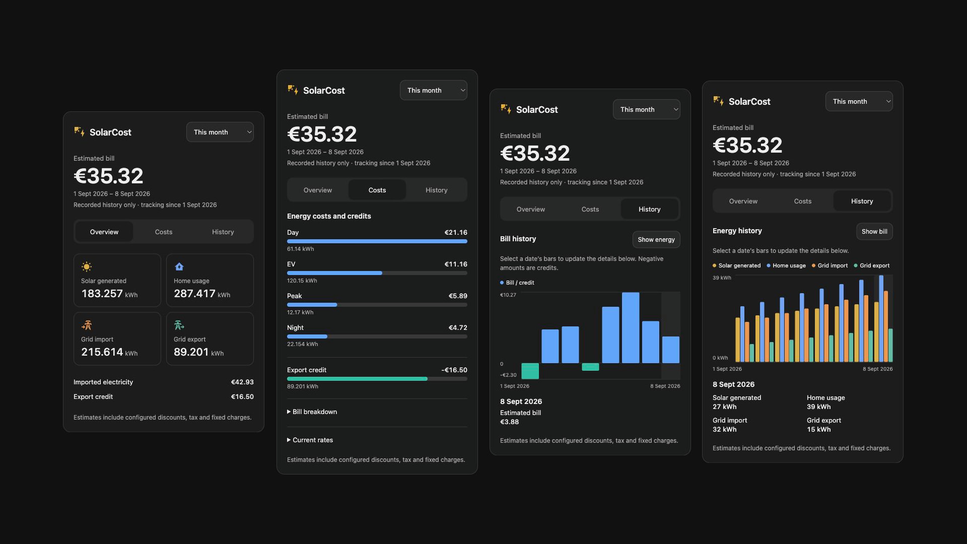

The bundled card has three views: Overview for energy totals and the estimated bill, Costs for a breakdown by tariff band with an export-credit bar, and History for interactive energy and bill charts. It supports Home Assistant’s visual card editor.

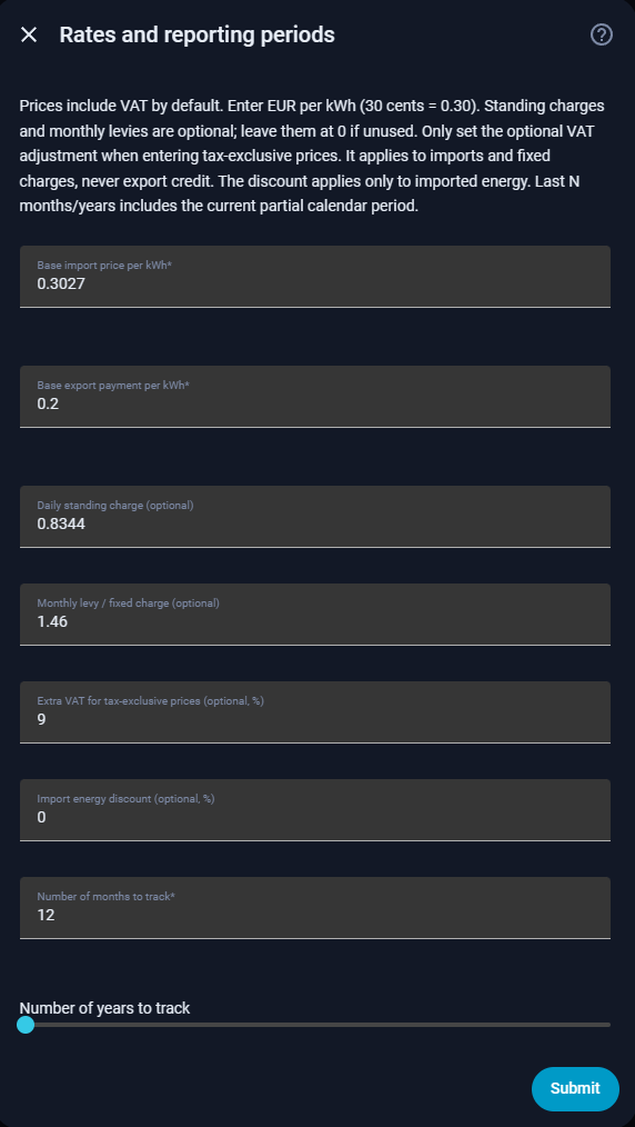

Installed, I’ll report back in a few days. I think I have this correct for Energia Smart Day Night plan
Edit: I think it is correct ex VAT. VAT is 9%
Looks about right to me - just check if your price is including or excluding VAT. I’m on energia smart drive plus and have VAT set to 0% since my price is given incl VAT.

Yeah, I only re-signed with them 2 weeks ago and have an email with both prices so it’s probably cleaner to just do all without VAT and set it.

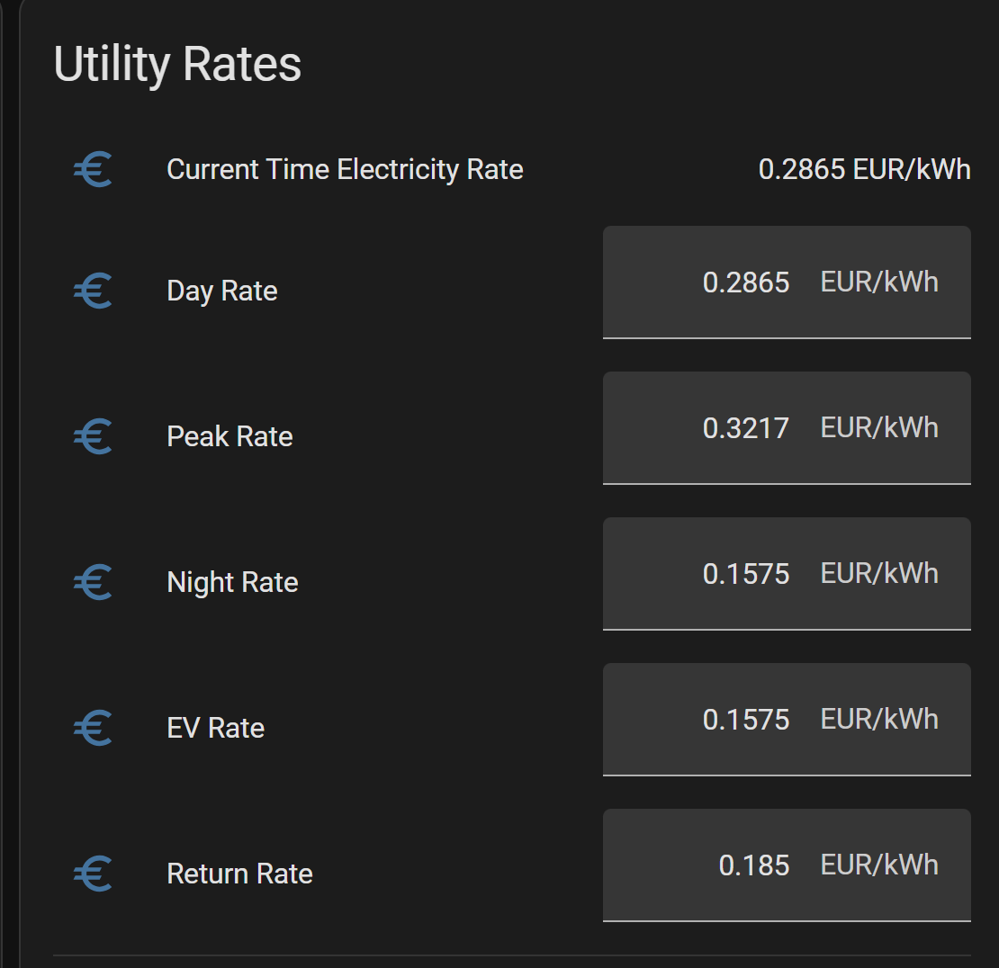

Is it (or can it be) possible to use an input_number entity against the rates
another Energia customer here and have HA mostly matching my bills using the inbuilt HA Energy tracking along with various templates, etc to get the import/export TOU rates right…be interesting to give this a go too to see what it throws out…
SolarCost’s Current import rate and Current export rate sensors can drive the price in HA’s Energy dashboard, so you can drop the input_number/template setup entirely.

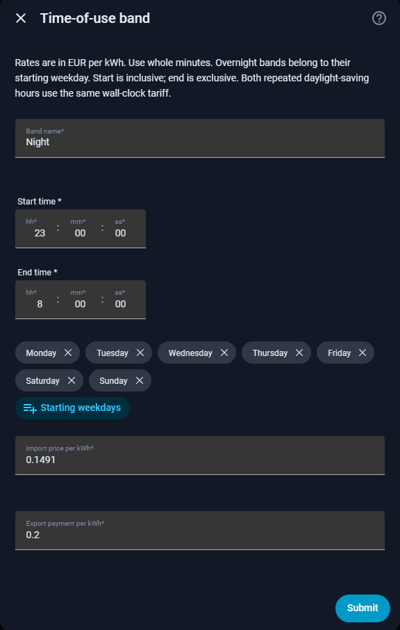

Map them straight across. Base rates (outside any band) import 0.2865 (Day), export 0.185. Then add a time band for each other window using your template’s times:
Band Import Export
Peak 0.3217 0.185
Night 0.1575 0.185
EV 0.1575 0.185
When Energia changes a price, update it in Configure → Rates/bands — it reprices from that point on.
