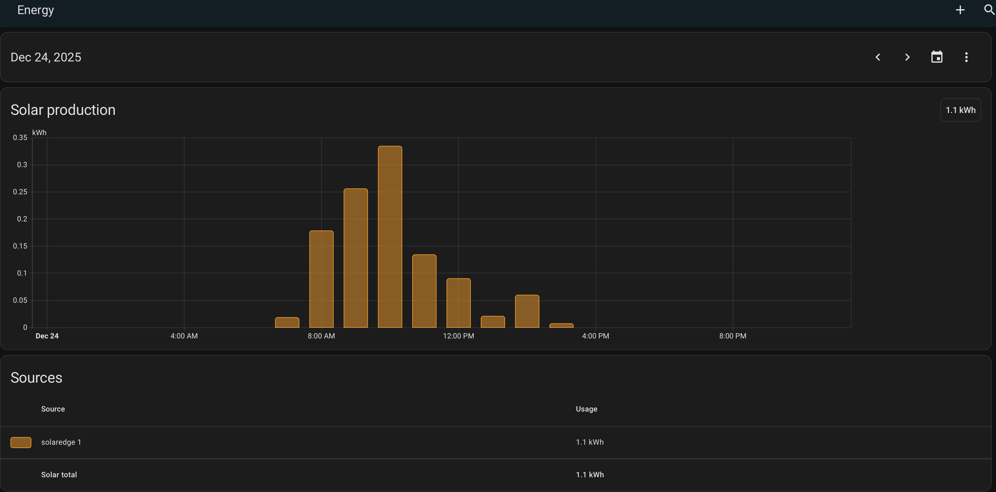

This now created an energy dashboard and gave me
SolarEdge 1, 1.1…1.2…
I am not sure if these are increasing version numbers where 1.2.x is the latest or if I need a specific revision
There are no sensors for this integration, though the energy dashboard shows correct Wh

This I am not familiar with. I have had to manually configure my Energy Dashboard. Can you provide a screenshot?
Maybe say which particular part of the energy dashboard is showing Wh. … and when you “edit” the Energy dashboard, what sensor has been configured with for that particular part?
Ok I figured out the 1.1, 1.1.1, 1.1.2 etc
I have 48 panels over 2 strings so string 1.1 and 1.2
Now for some reason that integration does not hav any sensors which is really odd and I cant really edit the Energy dashboard or see the yaml so I was trying to figure out what it was doing and the best guess is its polling solaredge 1 / 1000 to convert to kWh
