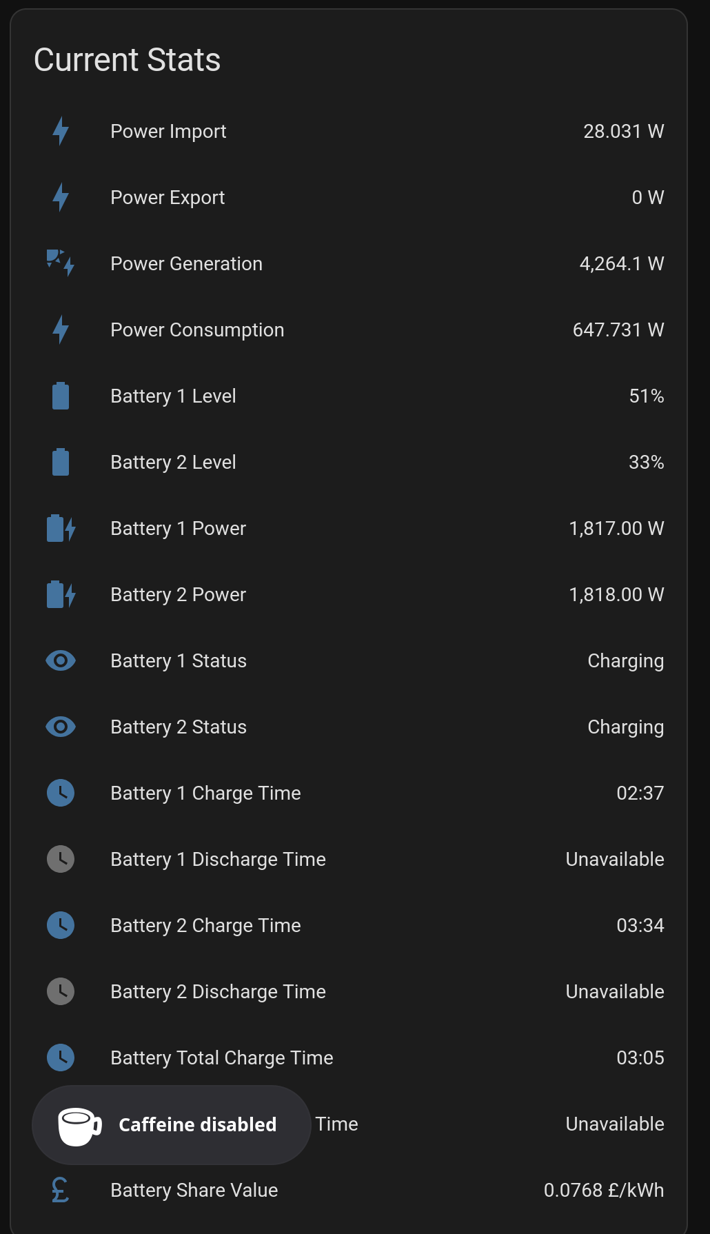

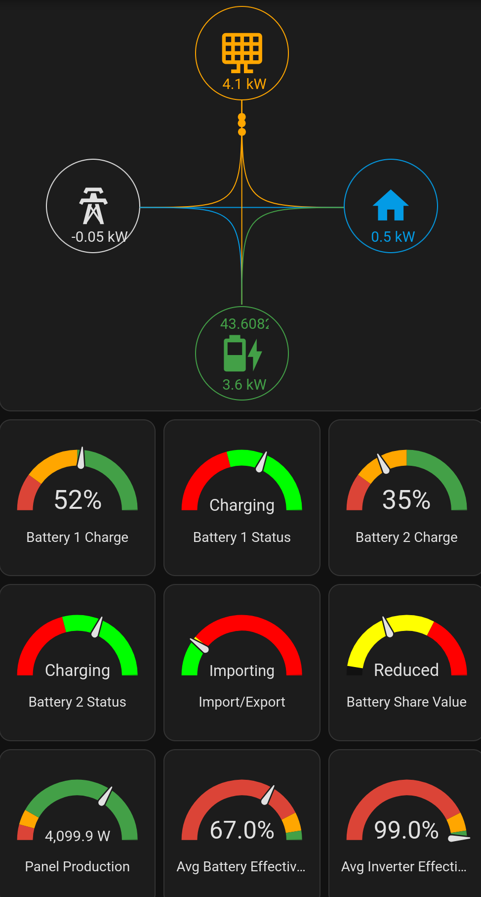

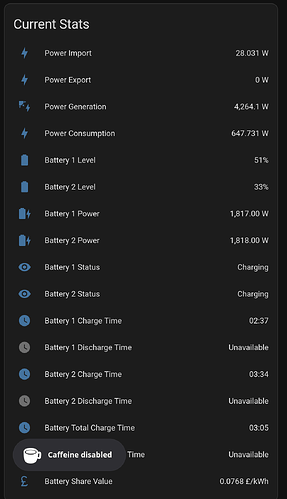

I’ve update my scripts to include a ‘share’ model for battery energy price…
(i’ve also got a 2nd battery)
The way it works is like shares in a company… you Buy shares from the grid BUT those shares get diluted by solar shares which are ‘free’ shares. giving you an effective share price for the energy in your battery… Simple example might be if i fill my battery from grid at £1 then use 50% of the energy but then fill my battery again from solar then the effective price of 1 energy unit in the battery is now £0.50 instead of £1.

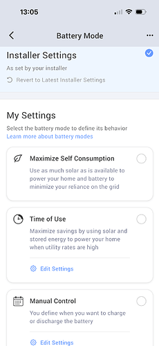

My SolarEdge battery is stuck in Time of Use mode.
If I attempt to change the battery mode to "maximise self consumption", "disabled" etc..... The request is accepted and battery behaviour actually changes, but then a few seconds later it reverts right back to time of use mode.

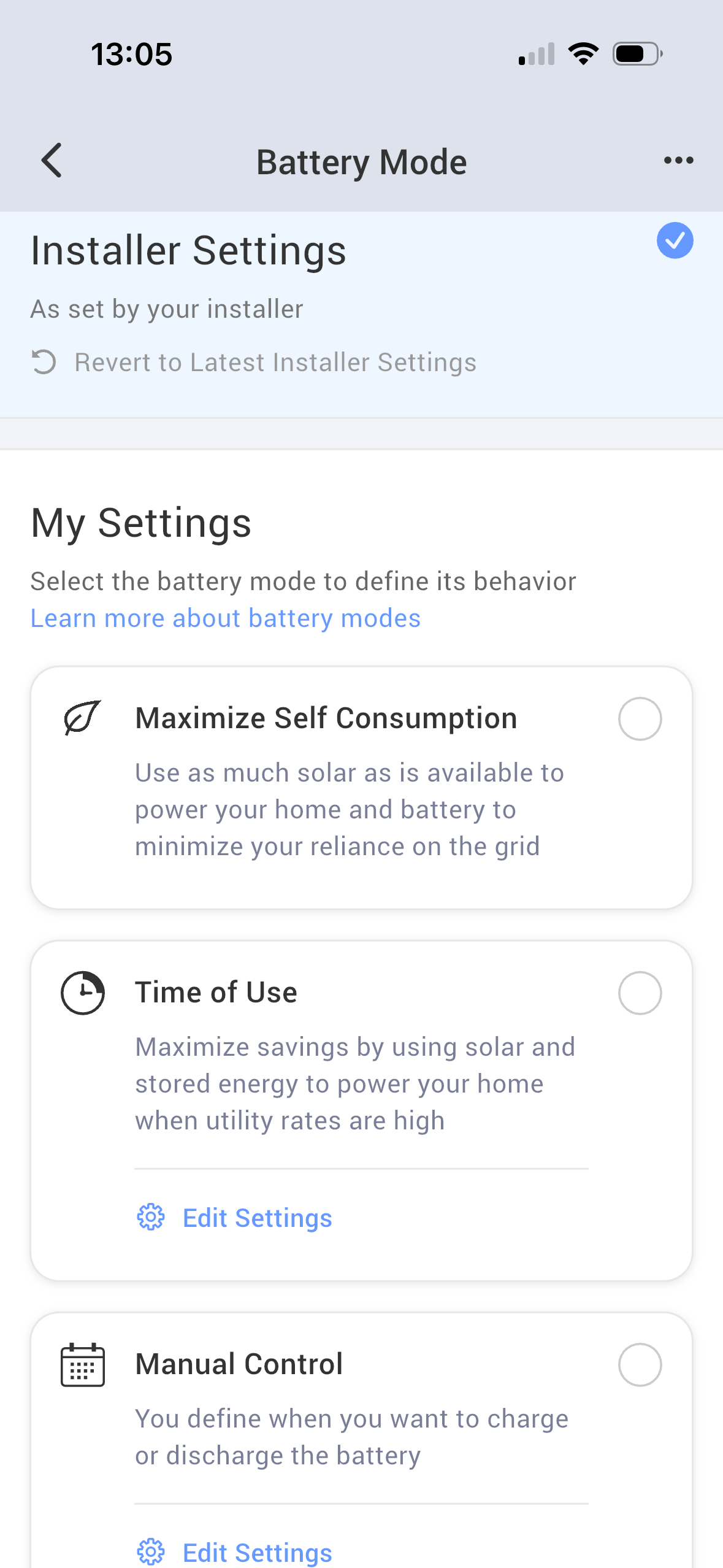

My Methods for doing this:
MySolarEdgeApp: Installer Settings --> Maximise Self Consumption
Monitoring Portal: Site Admin --> Energy Manager --> Battery Mode --> Installer Selection: Account Profile --> Disabled
SolarEdge Go / Webrowser Login to (172.16.0.1): Power Control--> Energy Manager --> Battery Mode --> Disable

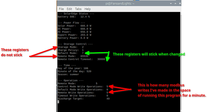

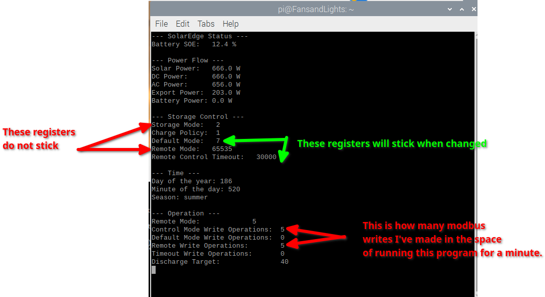

So here's the output from my program.
As you can see, the timeout value of 30000 will stick, as does the default mode.
But the battery control mode keeps reverting back approx every 10 seconds, same with the remote control mode.
A modbus register is only written if different to the commanded state, so I've not had to rewrite the default mode or the timeout.
Can someone please tell me if they've overcome this behaviour. I don't like to brute force my modbus writes every 10 seconds, as I'm guessing the registers are written to flash memory on the inverter, which could cause premature wear of the flash memory.

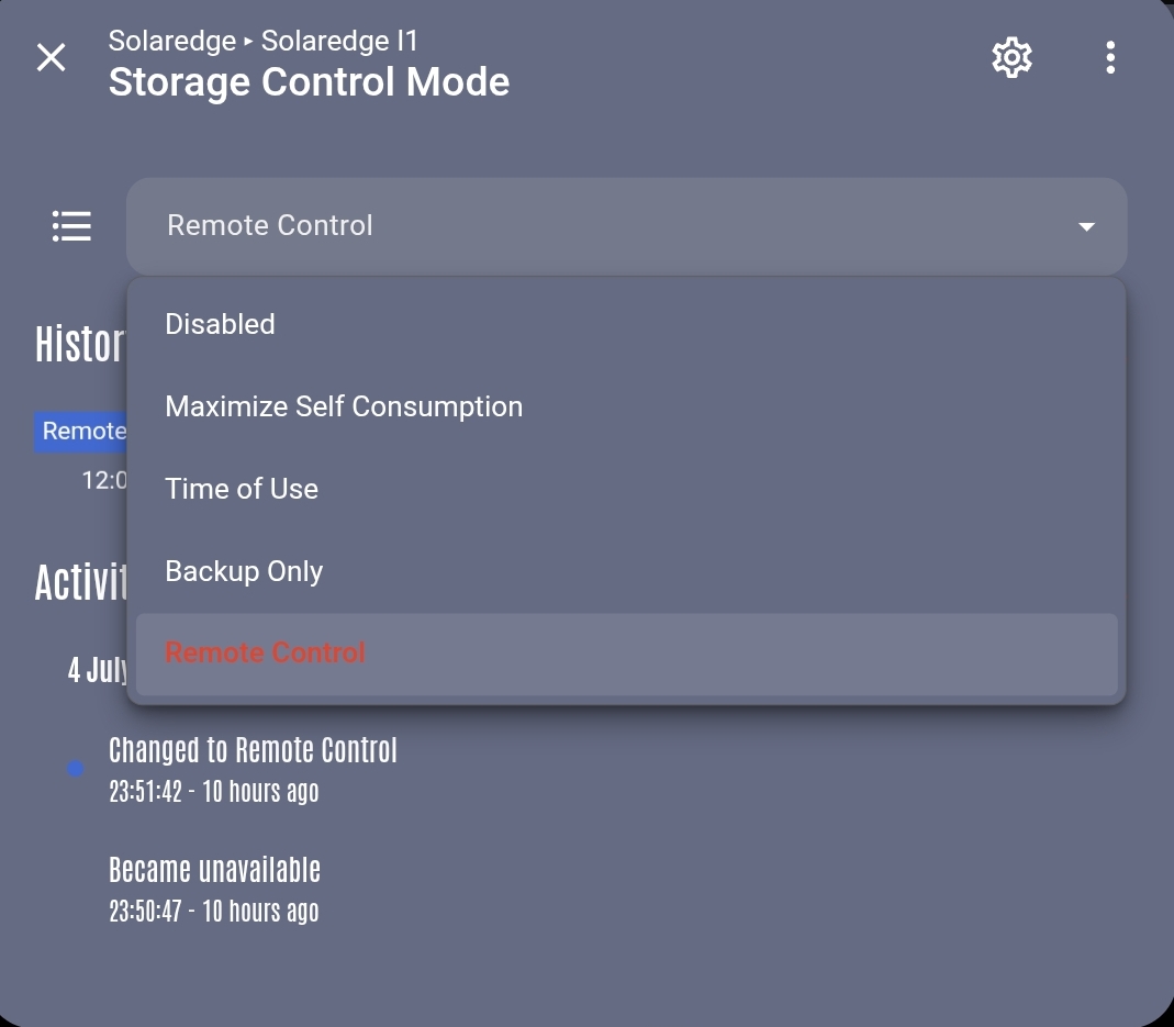

I've been a Solaredge site owner and Home Assistant user for several years. I was controlling our SE system comprising 2 inverters + battery before SE introduced control via the MySE app.
I can't quite tell from your post, but for me, the key setting is this one
From what i understand, if this setting is in anything other than Remote Control the battery will always revert to whatever the the installer or SE set it to.
This may not at all be relevant to your situation, but it might also be a good place to start.
Hope that helps.

I don't have the remote control setting in MySolarEdge
I don't have the remote setting either in the monitoring portal
Within SolarEdgeGo, I do have the greyed out option for "Remote+TOU", which I can't select
But the remote mode is besides the point here.
If I select any other mode, besides Installer time of use, it will revert right back to the time of use mode after 10 seconds.
For example:
If I select "Maximise Self Consumption" in MySolarEdge, then it will enter that mode for a few seconds, before reverting back to Time of Use.
If I can overcome this overriding effect, then I'm sure my remote mode commands send via modbus will also work. But this is a problem I've been trying to deal with for the last three months, and sadly to no avail.

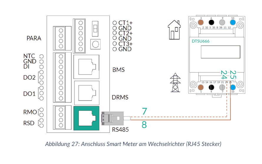

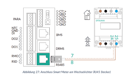

Hello, how can i do that, with my strong energy - alfred 10 - DTSU666
PLEASE
SE inverters have a strange habit of resetting once or twice a day. When it resets, Home Assistant momentarily loses contact with it. If you have something going on during a reset, the inverter reverts to it’s default settings so you need to monitor for the reset and add actions in your automations to deal with it.
I don’t have the SE EV chargepoint, but if for example I’m grid charging the battery or have shut down the battery because I’m charging the EV and I don’t want the battery discharging into it, when the inverter resets it completely mucks up the settings I need to ensure all of that happens.
So I watch for it happening in my automations and act accordingly. Here’s an example from my own EV charge automation.
