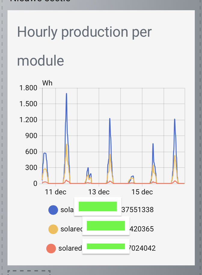

Ok,so after having entered my credentials in a reconfig flow (hadn’t seen that before), and a nights sleep, I can now see the modules in Statistics.
But, we can not click them for more-info dialog and get their full entity_id or what would we call it in this case. SO cant edit a card in the UI editor in yaml myself
The UI does show them in the UI editor, and that at least shows the integration works :wink:
too bad the naming seems to take the serial number (?) and not the panel number in the layout. Which makes organizing this a terrible experience.
But I guess after an hour or so, a card should be produced.
FR coming up for adding module layout number
