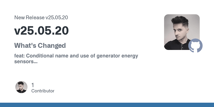

might be to do with the change in v25.05.20 if you you updated the component to or beyond that version recently as some sensor names changed in that release…
There has never been a sensor with that name (ID). I wonder what happened.

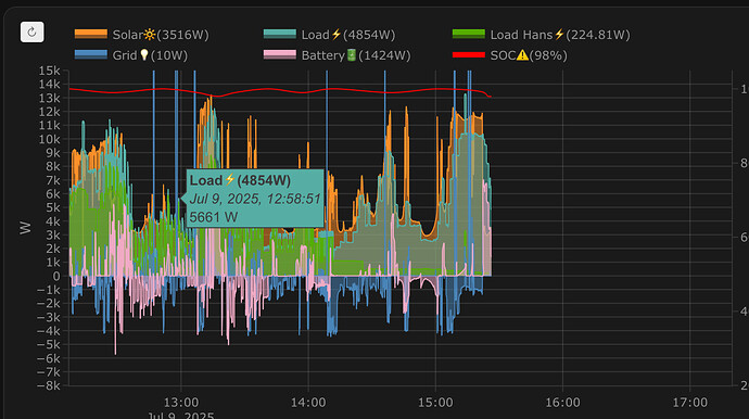

Hey, I do get some strange Grid readings → form time to time excessive grid import of 100kW and higher readings from my DeyeSUN-12K -SG04LP3-EU → has anybody an idea where this is stemming from? (the blue spikes in the attached screenshot) Currently I am bypassing the problem by fixing the y-axes in the the plotly graph, however it would be lovely if I could identify the root cause and correct the readings :slight_smile:
