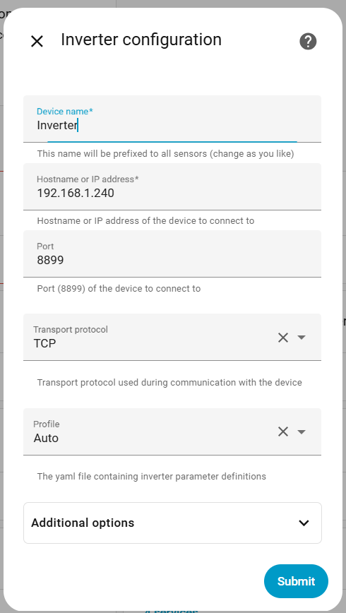

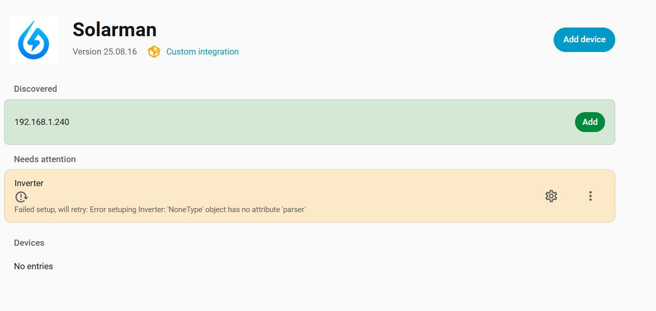

I have configured the adapter as follows:
The stick is reachable on the ip on port 80 but not 8899
I tried every inverter on the list without success and always get the error:
“Failed setup, will retry: The data address received in the request is not an allowable address for the server.”

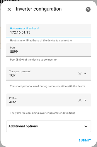

@davidrapan - May I please ask for your help? It seems that the integration connects successfully but the connection is closed then retries again.
My logger is LSW3_15_MQTT_270A_1.22, similar as @uswong (except mine is later version) which he got to work with sofar_g3hyd.yaml. I have tried all the sofar yaml files but keeps on getting the same message in the logs.
According to the logger interface, the infverter type is Sofar_G3.

EDIT: Fixed by changing to the Sofar_Hybrid.yaml profile

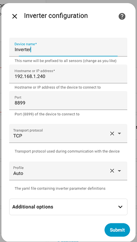

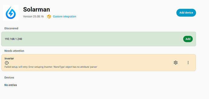

I have tried to add the integration after deleting it completely. the Logger device is auto discovered, but when I add it I get this:
My config set up was the default:
My Inverter type is the Sofar ME3000SP
Any tips on how to get the Integration back again? The logger is on SW version: LSW3_15_FFFF_1.0.57 V1.1.00.05
I have never made any changes manually to the Logger since it originally worked with the Integration. All data is being collected in the “Solarman” phone app and the “Sofar View” phone app.
Thank you for any advice
