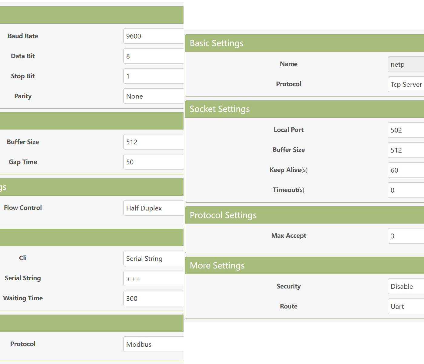

So I assume it should work with Elfin EE11a and EW11a also?
It works with the Sunsynk HA Integration.
The config of the Elfin uses port 502 so I tried your integration with port 502 instead of 8899. “failed to connect”.
As far as I unterstood the solaman stick uses a non standard protocoll which is implemented by pysolarmanv5. Waveshare, ESP32 and ELFIN EE11a / EW11a using standard protokoll. So the question is: How to use standard Modbus to tcp protokoll with your integration?
I want to change to your Integration, because there are much more entities reported for Deye 3P inverters and I miss a lot of modbus-registers in the kellerza/sunsynk integration, like inverter-temp., battery-temp., Micro-Inverter switch for inverter-generator-imput…
Any hints how to use your integration with an Elfin EE11a or EW11a as it is a quiet simple Modbus to TCP device. Would be happy for any advice.
Thank you

I found this on your github repo, went one step further, struggled again and described the current issue there:
Perhaps a documentation for usb modbus-rtu sticks, waveshare, esp32 and elfin EE11a / EW11a would be helpful? I could provide the Elfin doc when my szenario is up and running. :slightly_smiling_face:

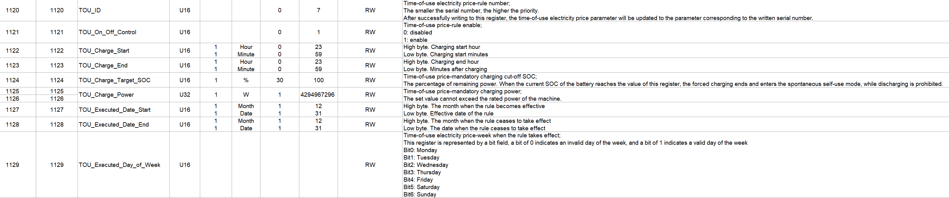

I’ve created the below automation to enable the TOU Rule 0 which I think aligns with the registry definition.
  - action: solarman.write_multiple_registers
      device: 905228336e90c08a75f802196c9d9257
      address: 4384 #0x1120
      values:
        - 0       #0x1120
        - 1       #0x1121
        - 256     #0x1122
        - 1536    #0x1123
        - 50      #0x1124
        - 0       #0x1125
        - 2000    #0x1126
        - 257     #0x1127
        - 3103    #0x1128
        - 1       #0x1129
mode: single
I’m getting the below error though
2026-04-26 23:51:05.298 ERROR (MainThread) [homeassistant.components.automation.tou_rule] TOU Rule: Error executing script. Error for call_service at pos 1: The value contained in the request data field is not an allowable value
for the server.
2026-04-26 23:51:05.300 ERROR (MainThread) [homeassistant.components.automation.tou_rule] Error while executing automation automation.tou_rule: The value contained in the request data field is not an allowable value
for the server.
Any advise on what I’m not doing correctly?
