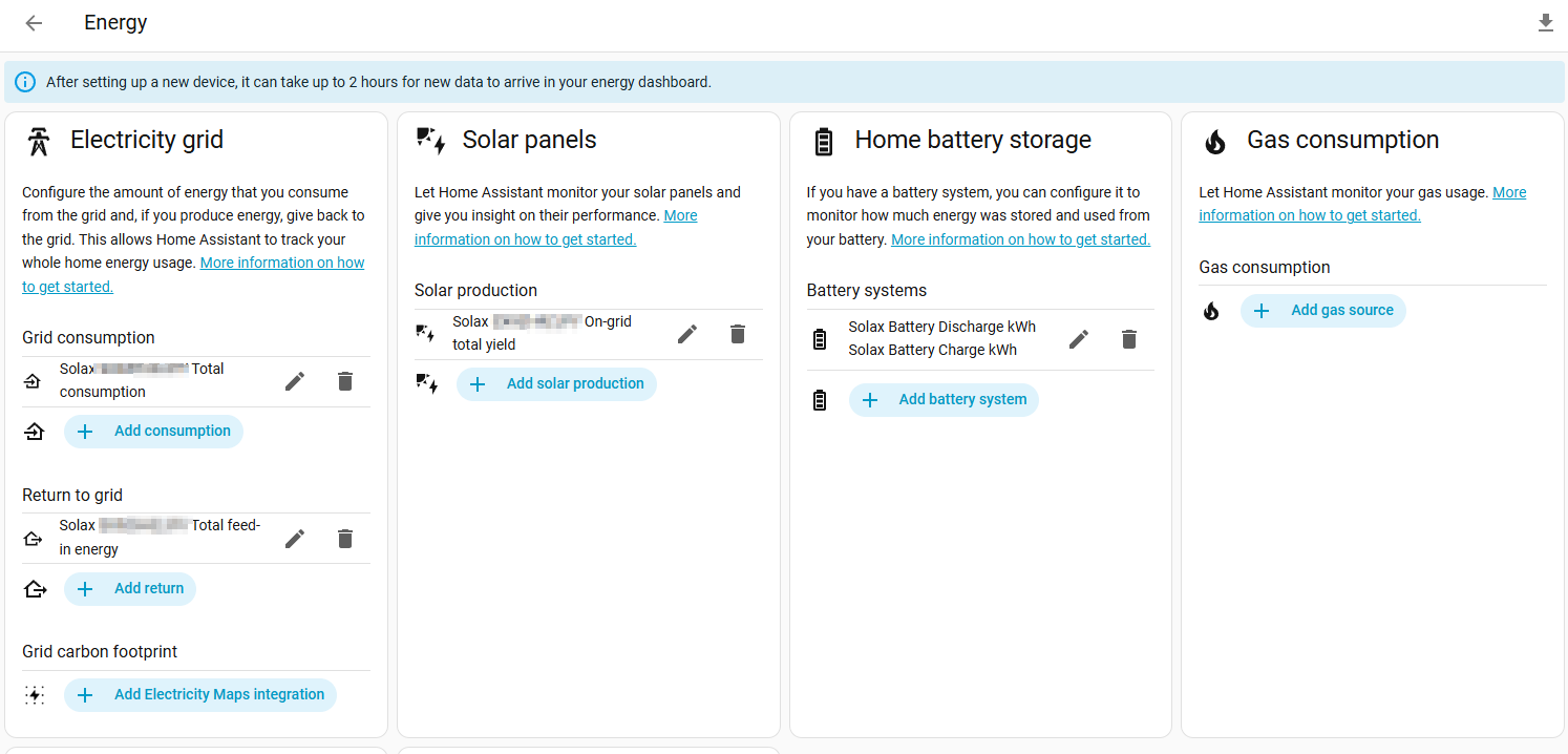

Hi, I have just added my Solax to the Solax Power integration but I wasn’t sure which options to go for in the configuration lists, does this set up look correct at a basic level? I appreciate it’ll take 2 hours / a few days to see data but just seeing if the actual selections look ok?
There wasn’t a relevant option under battery either.
I am new to this integration as QCell cloud API stopped working, see here for context.
I arranged it in a way is following the instrucitons at SolaX Power - Home Assistant: total consumption for grid consumption, total feed-in for return to grid, on-grid total yeld for solar production.
According to a lengthy discussion with chatGPT I resorted to two template sensors for battery charge and discharge as positive power W, with trapezoidal integral as kWh used int he energy configuration.

I am not that sure about these data so far.

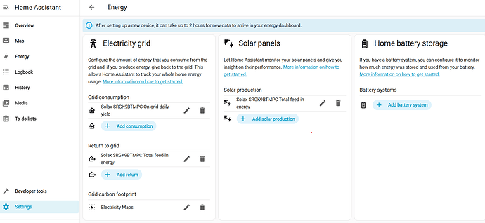

Did you manage to get satisfactory (i.e. correct) results?
