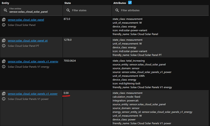

Since some days I’ve been having issue with powercalc that doesn’t give me correct restults. Am I the only one?
  sensors:
    - entity_id: sensor.solax_local_pv_output
      name: Solar Panels V2
      fixed:
        power: "{{ states('sensor.solax_local_pv_output')| int(default=0) }}"
    - entity_id: sensor.solax_cloud_solar_panel
      name: Solax Cloud Solar Panels V1
      fixed:
        power: "{{ states('sensor.solax_cloud_solar_panel')| int(default=0) }}"
    - entity_id: sensor.solax_cloud_battery_use_in
      name: Solar Cloud Battery In V1
      fixed:
        power: "{{states('sensor.solax_cloud_battery_use_in')}}"
    - entity_id: sensor.solax_cloud_battery_use_out
      name: Solar Cloud Battery Out V1
      fixed:
        power: "{{states('sensor.solax_cloud_battery_use_out')}}"
even if the expression “{{ states(‘sensor.solax_cloud_solar_panel’)| int(default=0) }}” return a value, the results of the sensor from powercalc is 0.
Any idea what to check? I didn’t modify anything, probably just updated powercalc
UPDATE: It seems it get the value when I restart HomeAssistant, but then it doens’t upate or it does for a short period of time
UPDATE 2: the behaviour seems related to version 1.17.7. Rolling back to 1.17.6 seem to fix the issue
Aren’t solax_cloud_solar_panel and solax_cloud_panels_v1_power the same thing? I’m using 1.17.7 and not seeing issues with energy calcs. I’m not calculating power like you seem to be.
Yes, the result should be the same power (W). It is just not updating after the startup of HA. It calculate the first time and not anymore until next restart.
Version 1.17.6 works perfectly
My point is that I’m not sure why you would create this sensor as it is already a real sensor.
The goal was to create an energy sensor from the power sensor to put it in the energy dashboard in HA. Honestly I followed this (and maybe others?) guide some years ago to set it up and it worked since then. I haven’t checked if there is any better way to do it.
Anyway some regression seems to be introduced with last version:
