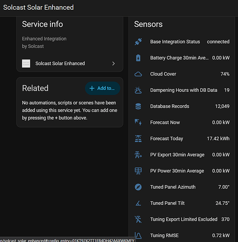

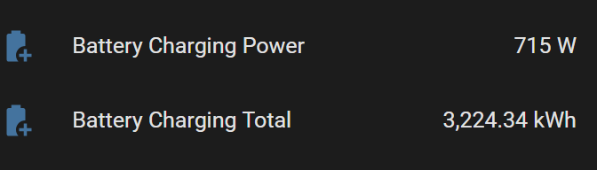

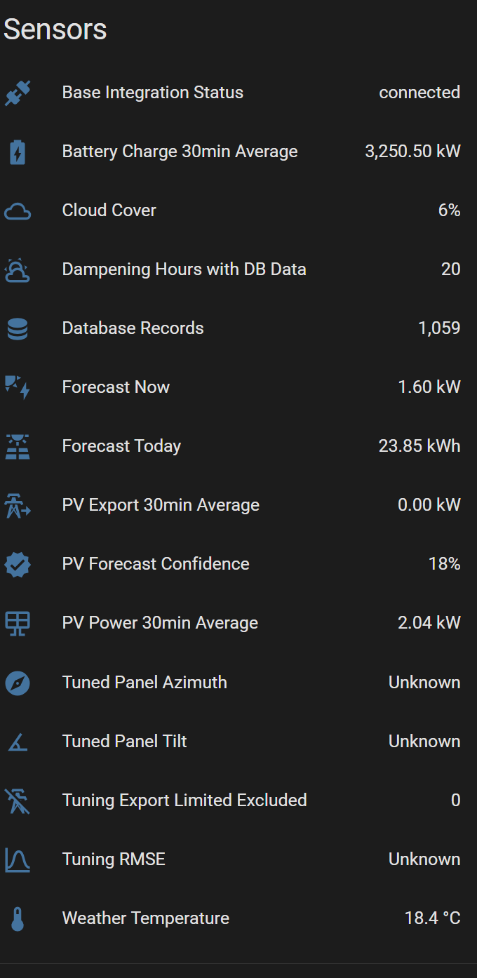

Quick question, the battery sensor is that a energy meter (kWh) or sensor (W).
Also not sure if it is working properly, should i have data in tuned panel and tuned RMSE
Thanks

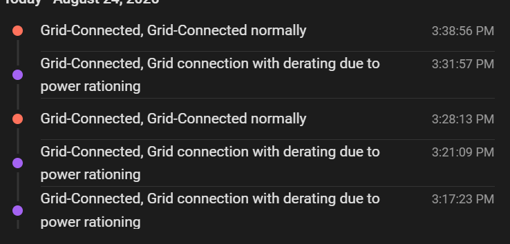

This looks great, as you can see my solcast forecast is consistently too high…and I have zero obstructions on my panels.
My question is how this would handle a zero-export restriction?
Our house is not yet approved for export (been on the list for 1 year waiting…), so often during the day our inverter status says “Grid-Connected, Grid connection with derating due to power rationing” which essentially means that their is excess power available but we are not consuming it.
How can I use the derating feature so I can pull down that Solcast forecast, but ignore the data when it is derated?
Hey Mate, have a similar issue with my place in that I have an 8kW system and 5kW export limit. With a Fronius Gen24 I can tell the export is the limiting factor for solar generation based on a 30min period with approx 5kWh output and voltage starts to increase over 400volts per string. As there is no real way to determine what the max output might have been currently I discard these records from any calculations and dampening. Open to ideas on how the integration could solve this. Cheers

Hey Mate, The battery sensor is in kW. That said at this stage I do not have a battery to test. And TBH I am not sure it really adds any value to the integration or the calculations it performs.
Regards,
Jim

:electric_plug: One combined meter? There’s now an option for that (b4)
If your system reports all its solar through a single sensor with nothing per array — a Tesla Powerwall 3 being the clearest case, since Tesla removed per-string data from every consumer API — the setup wizard previously had no option that fitted, and you simply couldn’t get past the per-array page.
There’s now a third choice: “one combined meter, no per-array data.” It asks for nothing else and tracks your property as a single system.
You lose less than that sounds like. Dampening is worked out per hour, so with an east array and a west array, the east one dominates your morning total and the west one your afternoon — a morning shading loss still lands in the morning hours of the correction. What a single meter genuinely can’t give you is the per-array sensors and per-array tilt tuning.
:warning: Worth checking if you have a multi-array system. The same release fixed a bug that could quietly switch your dampening off. If you’d mapped the same generation sensor to two arrays — easy to do, because that field used to come pre-filled with it — each array recorded the whole property’s output. Every per-array ratio then read roughly double, and since a factor above 1 gets clamped back to 1, the result was no dampening at all. Nothing warned you. It’s now a clear error, and the field isn’t pre-filled where that suggestion was the trap. Open Configure and have a look at the per-array page.

:folded_hands: Feedback wanted
Two things I genuinely can’t test myself:
  • Powerwall 3 owners — the new combined-meter option was built from a user’s description of what those integrations expose. I don’t have one. If you try it, I’d love to know whether it goes through cleanly.
  • Anyone with heavy morning or afternoon shading — the shading map is the first release of a fairly involved bit of physics. It’s read-only so it can’t hurt your forecast, but I’d like to know whether the bearing and elevation it reports match what you can actually see from your roof.
