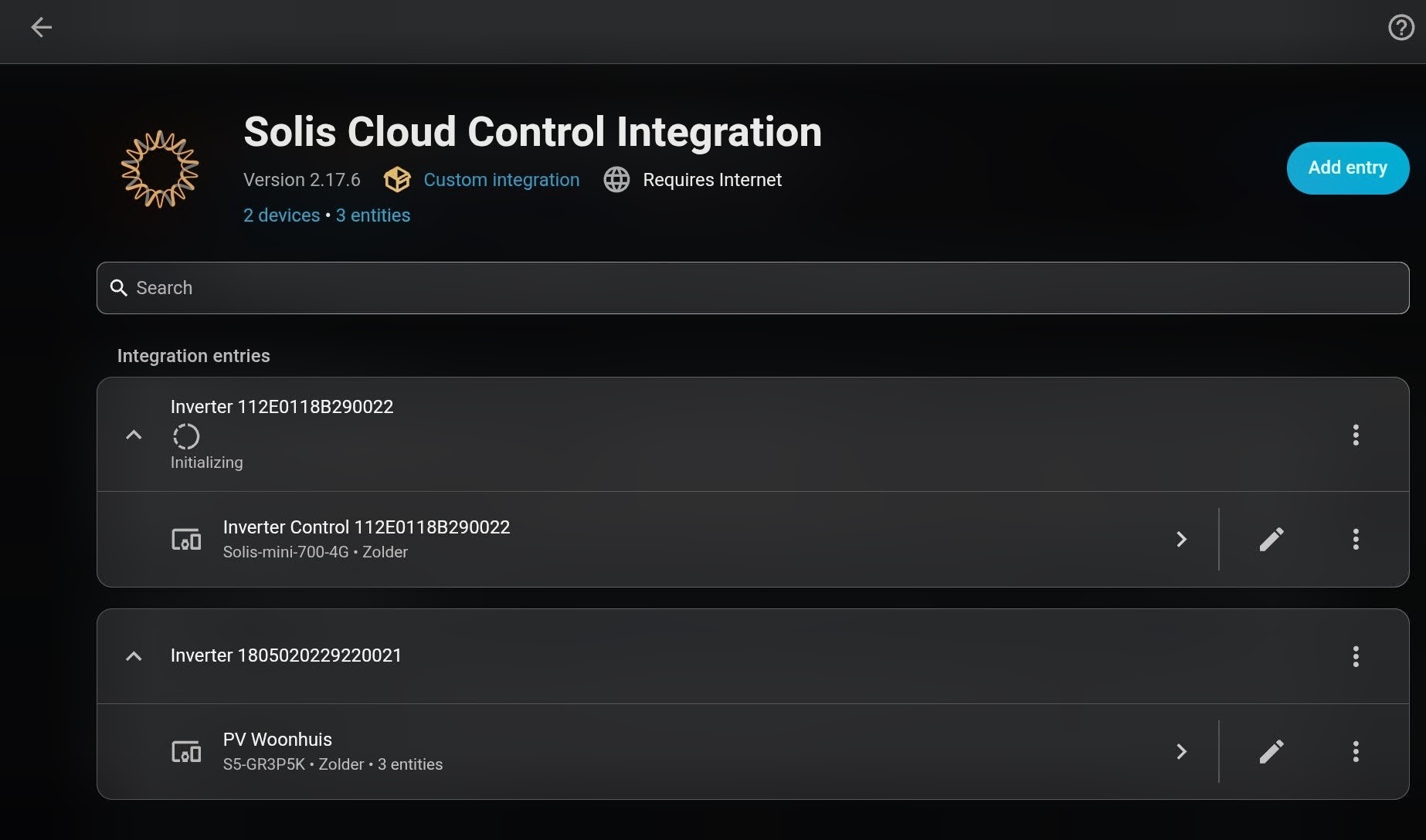

I'm new on HA but have managed to load all my devices into HA. This including my two Solis inverters. I've let Solis suppert enable the API's and installed the cloud control Integration via HAC. So far so good. But rhesmaller and older inverter (2019) gives an initialization error. The larger one (2023) does not but only shows limited devices (on/off, date &time, max load). Nothing else. No control items. Both invertors are connected via WiFi (s3-wifi-st for the larger model)
Just to be sure. This behaviour is because of firmware limitations due to the age of the invertors? Any other trics that might work and give me more control and information?
See also the screenshot
Thx, Hans

On your first point - there is a given list of supported inverters. The S5-GR3P5K is on this list, so yes this is recognised. Your other inverter is not on the list, and either cannot be added or you will have to reach out to the integration author to ask about your specific model. There is a note at the bottom of the supported inverter list on how to do this.
On your second point - the integration does nothing more than provide access to the Solis cloud-based controls that you can probably see using the standard Solis cloud app. These will expose, to the cloud, the specific controls available for the inverter, which clearly depend on the particular model. My hybrid inverter has many controls for SOC setting, for energy storage modes, and timed charge / discharge. I have looked for the manual for the S5-GR3(5)K, and this suggests that the inverter settings include only the date/time and inverter id address. If this is indeed the case, that this inverter model only has settings for date/time, then yes you are likely to only have three entities created by the integration - one for turning the inverter on/off, one for setting the date/time, and perhaps one for setting the id address.
As your inverters are probably not controllable, you may find it more useful to just bring in the various inverter values (power / energy / status). There appears to be a companion integration for cloud-based Solis sensors:
https://github.com/hultenvp/solis-sensor/
That integration should work for you and will provide a great deal more useful information.
