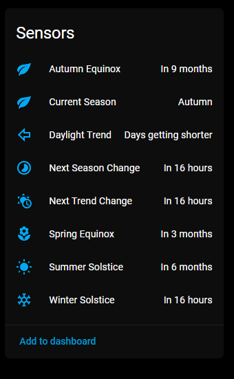

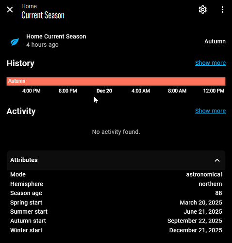

Hi. I have installed the integration a few days ago; I am monitoring the accuracy.
Today is Sat, Dec 20. The integration is saying season change will be in 2 days on Sun, Dec 21. The days remaining should read 1 day. My initial setup is for the Northern Hemisphere and I set the mode to astronomical as you can see in the 2nd screenshot.
I’ll bet the sensors update infrequently since there really isn’t a reason to have them constantly updating. Maybe once or twice a day?
The sensors probably haven’t updated since your date rolled over.
Edit: looks like they update once per day.
UPDATE_INTERVAL = timedelta(days=1)
Hi @duceduc,
@iamjosh is right - the 24h update interval starts from when Home Assistant (or the integration) boots, not from midnight. That’s why the value can be “off” for part of the day.
As a workaround, you can reload the integration (Settings → Devices & Services → Solstice Season → ⋮ → Reload) and the values should update immediately.
I’ve already created an issue for this: #6 - Update at midnight instead of 24h interval
Not sure yet when exactly the fix will land, but it will be included in the next release. The plan is to refresh shortly after midnight so the values are always accurate for the current day.

Hello. Today is Sun, Dec 21. The season should have changed and the countdown for Spring should appears.
Reloading the integration does nothing to change the values. I can see all the values have been updated because all the sensors says updated in seconds ago. However, the 16 hours still remains as 16 hours. I also, reloaded the integration yesterday when it was reading as 2 days. It always shows 2 days. Perhaps we need to reboot HA instead??
Additional observations:
  • I’ve done a reboot of HA. Not restart. No changes.
  • Since it is showing hours and not days remaining. The hour countdown start 30 min past the hour and not on the hour.
I think the time until the season change is correct. The change happens at the same moment around the world, so whatever your local time is at that moment.
The winter solstice is at 15:03 UTC on December 21. That’s officially when the season changes to winter, as well. The season does not change at midnight local time.
You could have attributes for both “most recent occurrence” and “next occurrence”.
I’ve believe you are correct. So from my calculation, the season change will happen at 12:03am local time for me.
I also do believe the default HA season integration will change at the same time as well. Will know when I am woken up from all my air conditioning devices and toilet are set to do its self cleaning with every season change.
