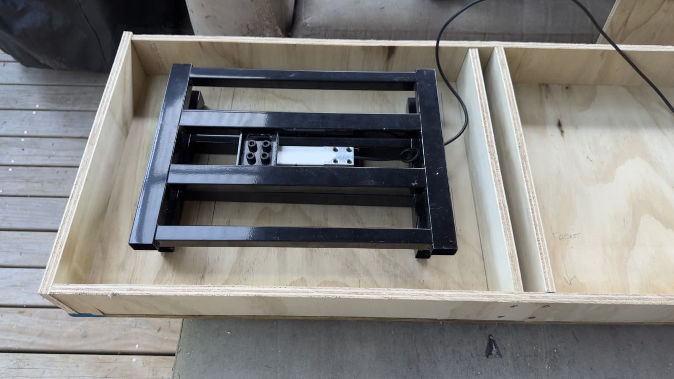

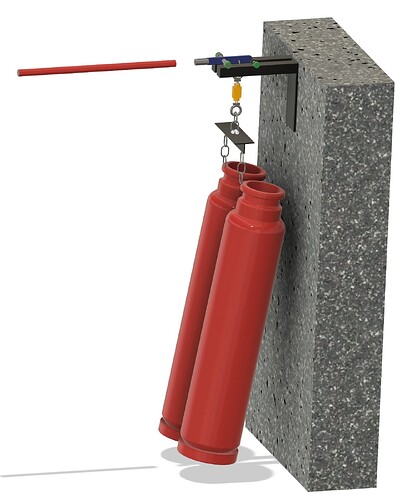

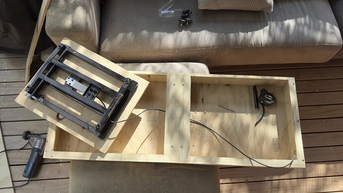

I think I’m going with this, using the load cell and amplifier I linked above.
With the 10:1 lever advantage, I’ll be lifting 20kgs for two full bottles and there’ll be an accurate reading.
Using that diagram, if your setup is similar, why cant you just use scales like I linked above? Just curious.
There’s far less hardware in my lift system and I don’t need to lift the bottles onto anything.

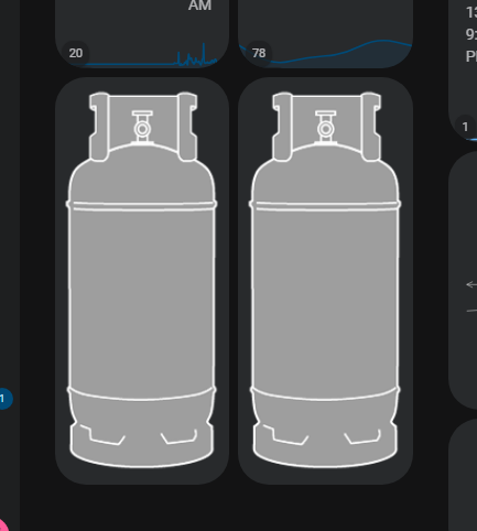

Does anyone know a way I can dynamically fill this image to disapply the bottle level?

I have completed this and happy with the result.

Yea on that note, I have this card that I want to dynamically fill using this integration but having trouble, maybe you could help me out?
The fill area is transparent.
Share your current card code and I’ll see if I can assist. I am fairly fluent in CSS.
Thanks
Well to be fair, I just stole some other code and tried, knowing that it would not work because its not suited for my image.
