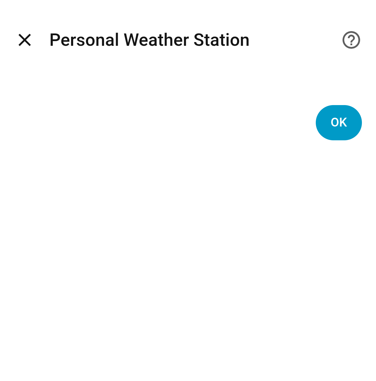

Hi, I installed the integration but when it comes to configuration der is only a blank page with the header.
No possibility to set ip address or anything else.
Restarted HA and reinstall of the integration is not working.
Any suggestions?
Thanks and greetings
Hi @steffenj
Did you tried to install the latest version (v1.0.3)?
Maxens
