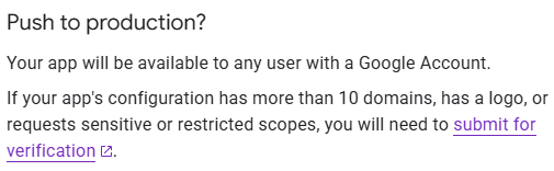

resurrecting this with a question: I’m having the same issue. The publishing status for my developer project oauth is Testing. I am aware that clicking Publish would probably fix my issue, however I get the following warning. What does publishing do at this point? I haven’t actually created an app, just credentials for HA to access my Google account. Nothing gets listed to the play store, or give anyone else access to this project does it?
Thanks
You have nothing to worry about.
Thanks. I published and applying the core update now. This will test whether publishing actually fixed the issue.
