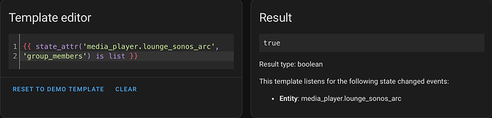

Does |first work on strings that look like lists?
No idea, but in this case doesn’t matter either way. The group_members attribute for a media player doesn’t look like a list, it is a list (assuming it exists at all of course).
Yeah sorry, forgot attributes could be other types.
