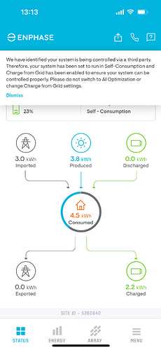

Hi guys,
I just saw this on my enphase App today and wonder if this means the API reflects this somehow
Any thoughts?

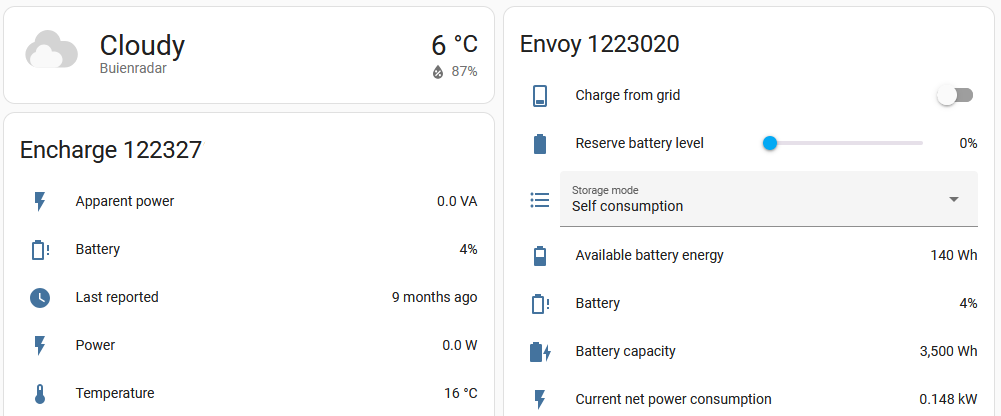

With prior versions it would show in the entities at the right hand top in below picture (of a simulation of EU battery configurations). Not sure if that is still the case with the recent firmwares.
Never seen this reported before. Maybe you can share this in the HA issue on all this as well.
Not sure what I should think off this. They clearly have a way to detect 3th parties communicate with the Envoy. But why you should not disable charge from grid is unclear to me. Unless that’s a country rule.
Think you can’t change it from HA anymore, but assume you can change it in the app. So why tell you not to. Same for the storage mode, would you be able to change that mode.
Maybe ask them the question why?
An US user shared that the AI mode seems not ready for prime time, wonder if that is realted to this.
Do you have any other equipment that may triggered this? Like ev charger or anything else?
Hi @catsmanac
Thank you for your response.
I actually have - sorry.
I have a Soly Brain in place (didn’t pay much attention, because this EMS came with my PV system and it wasn’t able to do anything then monitor, which I do with HA).
Anyway, this EMS is based on gridX same as the EMS “heartbeat” of :zap: Heartbeat AI: Günstiger Strom aus Sonne & Wind.
Anyway, one of the key features is to charge from grid, which was (and still is) not possible with the Soly Brain.
So, I think this message above indicates another special agreement with Soly like with 1Komma5Grad, which supposedly already can charge from grid according to [Guide] Anbindung einer Enphase IQ-Battery an EVCC · evcc-io/evcc · Discussion #12103
In my case the “Charge from Grid” switch is still available (still on FW 8.2.4382).
I will also share this in the issue lik you’ve mentioned.
I am pretty sure that it’s not a local regulation here in Germany, but more related to the fact that the AI optimization is not handled by enphase, but the 3rd party (gridX EMS).
That would make sense as two AIs would not be able to negotiate which has the higher priority.
And deactivation of “charge from grid” would not leave room for any optimization of the PV system.
I did not pay much attention to the profile setting in HA (just tested the enphase App).
I just remember, that the App setting was not reflected in the HA setting.
Now it is (self-consumption) - which fits.
In the App, I still can choose between AI and self-consumption.
(this makes sense, because I might want to switch off the 3rd party and rely on enphase AI instead)
In HA I just have SC, savings, max Backup.
In the Installer App I still can switch both:
Charge from Grid and discharge to grid.
whereas the latter is not allowed in Germany at the moment AFAIK (and does not make sense on the low prices of 8 cent per kWh.
I like that I still have the choice and enphase just recommends the proper setting in the dialog above instead of babying us :wink:
Thanks for the feedback @NCO3. So the message was triggered by the Soly and not by HA as I was thinking first. Two AI models driving would indeed be creating conflicts.
yes, sorry for not being precise from the beginning.
However, I am happy that there is progress on the enphase side.
I will continue to monitor if my Soly Brain makes progress on this.
