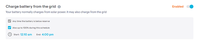

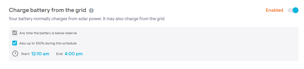

Hi, I really like the integration of Enphase on Home Assistant. I was doing tests this weekend and found 2 things that are not working great.
  1. If I disable the charge from grid while I’m in SC through the Enphase UI the battery start discharging as it seems to also disable the schedule. But if I do it through HA it keep charging to 100% from solar and runs the house using the grid. It seems to keep the schedule and disables the grid charging only. In my version of Enphase (Canada) I have Enable trigger to charge from grid but also a checkmark for a schedule when this is allowed but seems to be also to keep the battery at 100% even if charge from grid is disabled through HA. I checked in HA and I could not find a trigger for this schedule thing.
  2. Not sure if this is an issue or just a one off but I tried to disable grid from HA and it did something weird the first time I did second was OK. As soon as I did so my solar production went to 0 and only the battery was being used to power the house. Yet if I do the same via the Enphase UI solar production is possible and used by the house in conjunction with the battery. Second time it worked as intended.
Im also waiting to see if Enphase can put me in a DIY installer setup to see if I get even more options. TBD. I will update once this is done.
Hi @sdionne000 - greetings to Canada.
I am based in Germany, so my experience / system configuration might not by applicable 100%.
However, here are my two cents to your questions:
  1. I guess this is how it’s designed. If you disable charge from grid, it will not charge and the schedule is deactivated as well (which makes sense from my POV). On my system I can set a separate schedule to block the battery during a specific schedule.
  2. The HA to enphase API is very limited, so I cannot set anything regarding operation Mode (SC / AI) or battery behavior.
However, I use the AI since quite a while and it seems to work properly:
  1. When power is cheap and high prices umcoming, the battery will be charged from grid and discharged later to power the house.
  2. When I charge my EV and the power is cheap, the EV will be charged from the grid and the battery will be blocked (not dicharged).
    Sometimes it even charges both on low power rates: the battery AND the EV.
