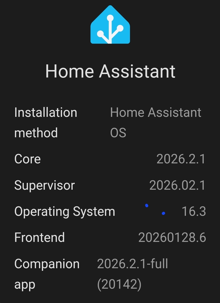

After several attempts to update HAOS to 17.0, I repeatedly get this error:
“Failed to perform the action update/install.
Error updating Home Assistant Operating
System: OSManager.update blocked from execution, system is not running freeze”
Is there a fix?
